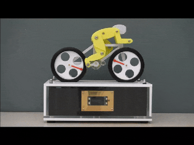

Step 1: Description
This is clock project in the form of a freestanding cyclist were the time elements representing hours and minutes are via the wheels.
Two separate and identical elements are used which consist of a stepper motor driven gear that drives a larger gear that represents a bicycle wheel arranged such that the drive gear is below the surface.
The reference start (home), position for the wheels are verified by hall sensors and magnets.
All this is controlled by a Raspberry Pi Pico with RTC and LCD used for both time setting and display.
The specific LCD display was chosen due to its small size and integrated push buttons negating the requirement for separate buttons and it had been used on a previous project.
The LCD displays the time in 24 hour mode whilst the wheels display the time in 12 hour mode.
All this housed in an acrylic case.
Size: 207(H) x 218(L) x 118(D) mm
Weight: 1.33kg
Supply current at 5V (static typ. 33mA), (active typ. 243mA).

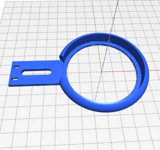

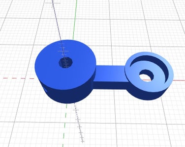

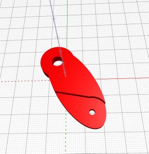

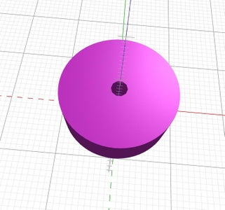

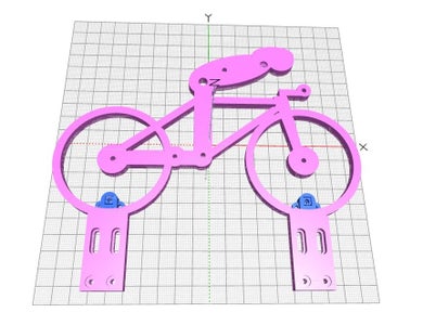

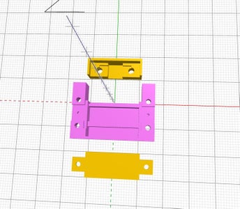

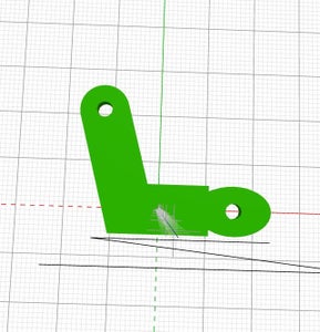

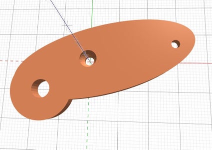

Step 4: CAD Design
The 3D printed elements were designed using BlocksCAD, sliced using Cura 4.5.0 and printed on a Labists ET4.

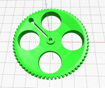

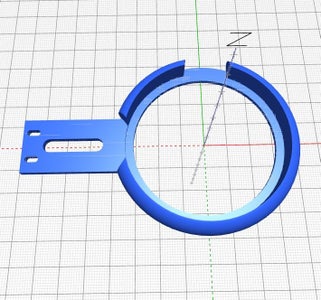

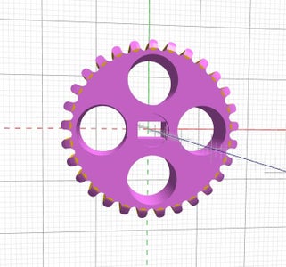

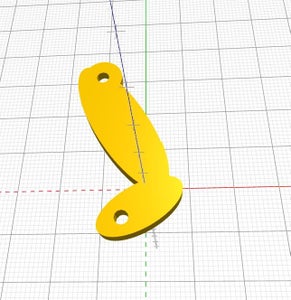

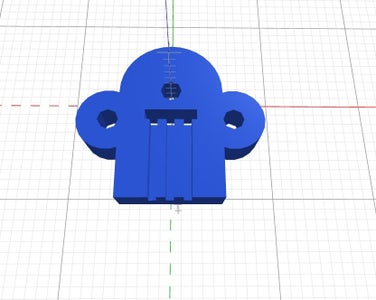

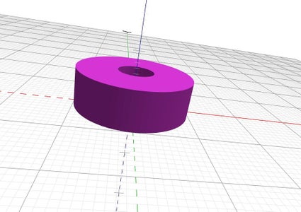

1: Cycle and cyclist upper body. Size:197(L) x 168.5(D) x 7(H) mm, Weight: 73g
2: Cyclist torso. Size: 59.1(L) x 33.4(D) x 5(H) mm, Weight: 7g - Qty 4
3: Cyclist arms. Size: 39(L) x 30(D) x 5(H) mm,Weight: 3g - Qty 2
4: Cyclist thighs. Size: 36.3(L) x 48.4(D) x 5(H) mm, Weight: 3g - Qty 2
5: Cyclist lower legs. Size: 25.7(L) x 46.7(D) x 5(H) mm, Weight: 2g - Qty 2
6: Pedals/Crank. Size: 28(L) x 12(D) x 6.5(H) mm, Weight: 1g - Qty 2
7: Hip spacers. Size: 20(dia) x 6.5(H) mm, Weight: 2g - Qty 2
8: Chainring spacer. Size: 20(dia) x 2(H) mm, Weight: 1g
9: Hall Sensor back. Size: 18(W) x 15.5(D) x 3.5(h) mm, Weight: 1g
10: Wheels (65 teeth gear). Size: 67.6(dia) x 7(H) mm, Weight: 15g - Qty 2
11: Front Tyre. Size: 118.5(L) x 79(W) x 11.9(H) mm, Weight: 17g
12: Rear Tyre. Size: 118.5(L) x 78.3(W) x 11.9(H) mm, Weight: 16g
13: Drive gear (29 teeth). Size: 31.6(dia) x 7(H) mm, Weight: 4g - Qty 2

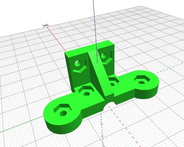

14: Motor Bracket. Size: 21.5(W) x 50(L) x 20(H) mm, Weight: 6g - Qty 2

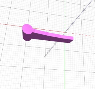

15: Pointer. Size: 24.4(L) x 4.6(W) x 9.5(H) mm, Weight: <1g - Qty 2
16: Nut Foot. Size: 12(dia) x 5(H) mm, Weight 1g - Qty 4

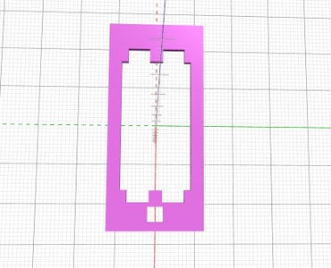

17: RTC box: Size: 22(H) x 32(W) x 7(D) mm, Weight 3g
18: Display Retainer: Size: 53(L) x 24.4(D) x 1.5(H) mm, Weight: 1g

Step 14: Display
A sandwich of two perspex rectangles of size (198(L) x 60(W) x 5(H) mm) black and clear are used to house the display.
In the centre of the clear rectangle measure and mark a rectangle of 24.4(H) x 52(L) mm.
Cut out the area of the measured rectangle using a saw, drill and file to accomodate the display.
In the centre of black rectangle and within the cutout in the clear rectangle measure and mark two slots of 2(H) x 52(L) mm spaced 17.78mm apart to accomodate the socket strips in the display.
Fit the display into the cavity in the box.
A 3D printed spacer surrounds the edge of the display glass and the buttons to fill the gaps, creating a uniform contrast and a firm support for the transparent film. Orientate it such that the small hole aligns with the LED. Press this over the front of the display.
The display is held in place by a brass surround and additional protection is provided by a plastic shield.
The plastic shield provides some protection to the LCD glass front whilst still enabling the buttons to be activated.
Cut a brass sheet to the following dimensions 65(L) x 38(W) mm and in the centre cut an opening 38(L) x 18(W) mm
Drill a 3mm (dia), hole coincident with the RGB LED on the display.
In the corners of the brass surround drill 4 x 2(dia)mm holes to accomodate self tapping screws.
Cut a piece of transparent film (PET or similar), from a blister pack the same size as the brass surround and attach with masking tape. Drill through the corner holes and attach the retainer to the box, using it as a template mark the positions of the buttons.
Drill 4 x 3(dia)mm holes coincident with the buttons in the transparent film and widen with a round needle file.
Fit the display retainer with the corner screws and carefully peel off the masking tape.

Step 17: Wheels
The cycle wheel is actually a gear with 65 teeth.
Rather than ball bearings a plain bearing (bushing), is created using a brass tube and rod.
Cut a 3.5(dia)mm tube to a length of >8mm and round the outer edge with a file.
Place the wheel on a firm flat surface with the back facing uppermost, orientate the tube with the rounded end placed in to the hole and with a piece of wood between the hammer lightly tap the tube in (alternatively, use a pillar drill with a similar protective separation).
With a file remove the remainder of the tube such that it is flush with the surface of the wheel.
Deburr the tube with a 3.5mm drill bit and/or round needle file.
Pointer
With a file smooth off the sides and edges of the pointer and pointer cavity in the wheel to enable it to be pressed into the opening.
Magnet
A hole is created at the opposite end of the pointer to house a 3mm diameter magnet.
Widen the hole as necessary and into the hole insert glue or epoxy putty and press the magnet in place.
The magnet is used in conjunction with the hall sensor to determine the homing position for the wheel.

Step 19: Hall Sensors
The sensors sit on the inner circumference at the lower part of the wheel in the integrated holder.
Solder 3 x 20cm lengths of wire to the leads of the sensors.
Pass the wires through the front of the holder and out the back.
Bend the leads at 90 degrees close to the body of the package such that the package fits in the cavity with the front facing forwards.
Bend the leads at the back 90 degrees downwards.
Screw the covers to the back of the holders with 2 x M2 x 6mm self tapping screws.

Fit a 6.5mm spacer over each end of the pelvic rod.

Fit Pedal/Crank
Open the hole in the pedal with a 3mm drill bit to allow a M3 screw to spin freely.
The pedal is orientated such that the recess faces into the centre of the cycle and is attached on the inside of the foot.
Thread a plain washer onto a M3 x 12mm machine screw and pass the screw through the pedal and then place another plain washer over the screw.
Pass the screw through the foot of the leg and place a plane washer over the screw and fix in place with a self locking nut.
Tighten the nut to reduce side to side play to a minimum but still allowing the foot and leg to rotate about the pedal with low friction.
Hold the top of the thigh between thumb and finger letting the leg hang down and swing the leg in line with its plane of movement. The crank/pedal should swing freely.
If leg does not swing freely, check for over tightening of the nut, missing central washer.

Intermediate gear
Fit a M3 washer followed by the intermediate gear (12T), and a M3 washer onto the 3mm rod beside the chain wheel gear (20T).

Fit the motor brackets under the enclosure top with M3 x 16mm machine screws and nuts.
Pass the wheel extensions with attached tyres down through the cutouts in the enclosure top and loosely attach to the motor brackets with M3 x 16mm machine screws and nuts. Loosely attached to enable adjustment.
Insert the drive gear between the wheel and tyre extension.
Insert the axle of the motor down through the tyre extension and into the centre opening in the gear.
Align the teeth of the drive gear and wheel and fix the motor in place with 4 x M3 X 8mm machine screws and 2 x M3 x 20mm threaded standoff.
Fix 2 x M3 x 10mm standoffs between the wheel and tyre extensions in the holes at the extreme ends and fix in place with 4 x M3 x 8mm machine screws, ensuring that the small stripboard is held in place with one of the screws.

Step 22: Final Assembly
The enclosure sides are placed over the enclosure base prior to connecting the required wires.
This will be held in place by the threaded rods and the pressure applied between the top abd based when the capped nuts are tightened.
Ensure that the leads connected between the lower part of the box and the underside of the top panel are long enough to enable work to be carried out with the top panel removed.
The USB_C board is connected to X11 (ensure to connect the right polarity to the pins).
The two switches are simply screwed into the holes drilled in the back of the box.
Reset is connected to X7.
Set enable is connected to X6.
The stepper motors are connected to X1(Hours) and X2(Minutes).
Due to limited GPIO lines a multiplexer made up of two IC's (74HC08), sit between the Pico and the motor drivers to switch the same 4 driver lines to the required motor by selection of one of the two appropriate select lines.
The LCD display sits at the front of the box connected to a sub PCB enabling jumper wires to be used to connect this to the controller board.
The RTC is connected to X5
The buzzer is connected to X8
The hall sensors are connected to X9(Hours) and X10(Minutes) at pins 3V3, 0V and OP(output)
Double check the wiring prior to completing the enclosure and applying power.
Sit the enclosure top over the four threaded rods making sure there are no wires trapped under the edge of the sides.
Fit a M4 plastic plain washer over each rod followed by capped nut.
Hand tightening should be sufficient to retain everything in place.

Step 25: Review
All challenges met with satisfaction.
1: The vertical back support board removed giving the cyclist a more realist horizontal support.
2: All the electronics housed beneath the cyclist.
3: Stepper motors installed to replace servo motors.
4: The pedalling action is driven by the rear wheel negating a 3rd motor.
5: Microbit replaced with Raspberry Pi Pico.
6: Wheels designed as large gears driven at the circumference by a smaller gear mounted out of sight below the surface.
7: Single custom PCB designed and implemented to replace multiple PCB's for 2 x motor drivers, multiplexer and GPIO expander.
8: Multi layer acrylic sandwich box implemented.
