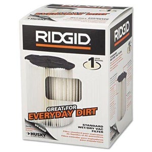

such as a Dust Deputy. You can make your own but... The first one I made myself took hours and was not nearly as effective. The dust deputy DIY kit about $50, but you can get a more expensive kit that includes the barrel and accessories. - Threaded Rod
I think I used 3/32" rod. Size doesn't matter, but it needs to be the height of the filter plus 2". - 2 Nuts and a Large Washer
That fit the threaded rod. - New Shop Vac Filter
Get new because otherwise you'll blow stuck debris from the exterior side of the filter into the air. When you use this filter; material gets added to the inside of it so you really don't want to use it on a normal shop vac again. - 3/4" Plywood
at least 1" bigger than the filter base. For me this was 5.5" square, if I did it again i'd make it at least 7x7" - Superglue
Just a few drops.

Step 3: Attach the Base to the Filter
I just threaded the rod into the plywood and glued it in place with superglue. It would be more secure to add a nut to the bottom of the rod and glue the nut to the plywood. The important thing is not to oversize the hole for the rod or air will leak out of the joint.
Place the filter on top of the unit & pass the rod through the hole at the top of the filter. Put the washer & both nuts on to secure the filter down.
Step 4: Install on the Cyclone Separator
Connect the hose from the planer to the cyclone separator. I used 2.5" hose which fits the Dust Deputy, connecting it to the planer was a bigger problem and I used a few plumbing pipes and adapters to make the connection.
All you need to do is place the filter tightly over the top of the separator.
