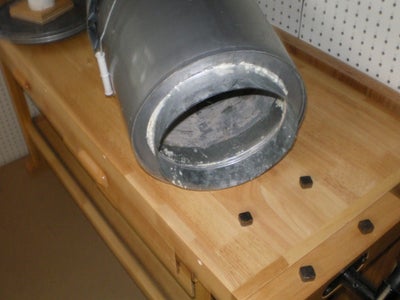

Step 4: The Bottom of the Top Part
I cut a hole in the bottom of the bucket with a sabre saw so that the small end of the fitting would fit. Then using Great Stuff foam, I foamed the inside, around the fitting in the void. It really did have sort of a conical appearance when I got done.
So much for the top container.

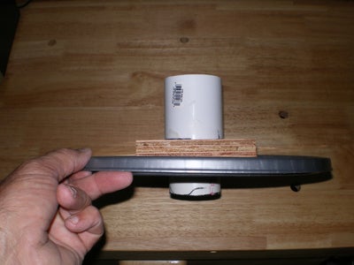

Step 5: The Top of the Bottom Part
That's it.

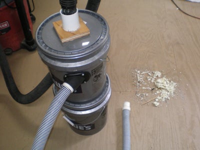

Step 6: Put Them All Together
Set the top part on the bottom part with the metal piece sticking through the hole.
Use a bungee cord to hold them together.
Hook up the hoses.
Note the pile of dust, dirt, and foam on the floor. It will be gone soon.
Step 7: Turn It On...
Two small problems. The assembly hardly weighs anything. I keep pulling it over if I don't chink it somewhere when I am using it. And, secondly, the bucket holds only five gallons, obviously. I have never vacuumed up five gallons of anything at once but it stands to reason I might, over a period of time. There is no reason why the bottom bucket can't be replaced by a larger - twenty gallon, for instance - drum. Also, however much the bottom container holds, you still need to check the vac filter occasionally, That's where the fine dust goes, and that plugs up the filter quickly.
