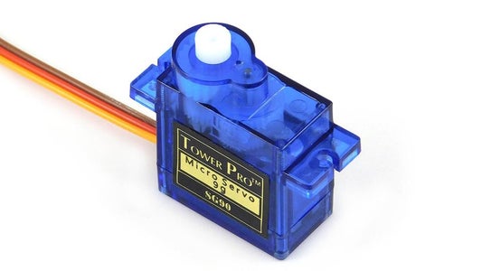

Servo SG90

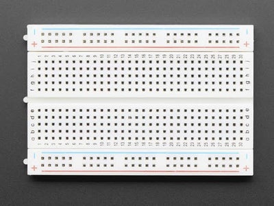

Breadboard

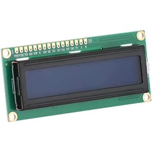

LCD screen 16 x 2

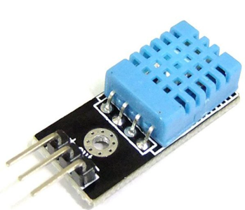

DHT 11 Temperature Sensor

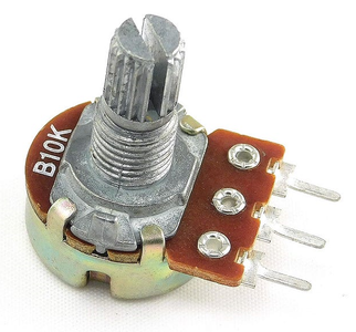

1 Potentiometer

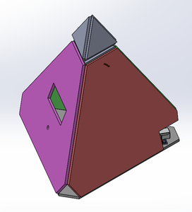

Step 1: Main Body Part

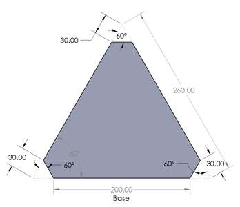

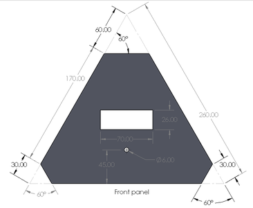

Cut the cardboard into four equilateral triangles of side 260mm as in the "Base" figure.
Base: Chamfer one of the triangles with 3mm to create the "Base".
Front panel: Cut the chamfers on another triangle as shown in the "Front panel" figure. Rectangular cut and circular hole are for placing LCD screen and Potentiometer respectively. Choose the dimensions so that the LCD and potentiometers fit perfectly.

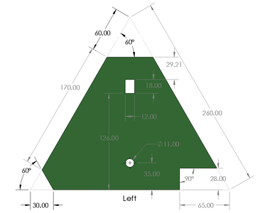

Left panel: Cut the other triangle taking reference from "Left panel" figure. Here, rectangular cut is for Temperature Sensor and circular hole for Passive Buzzer.

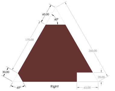

Right panel: Follow the similar instructions to get the shape as shown in "Right panel" figure.
Step 2: Assembling the Main Body
Join the "Left panel" and "Base". Make sure the joint should not be rigid but allows hinge motion to form a Tetrahedron.
Make a hinge with hard cardboard and join the "Right" triangle as shown above. - The hinge joint is provided for the "Right" triangle for assessing the internal circuits in case of any repair.
Join the "Right panel" to the "Base".
Step 3: Upper Body

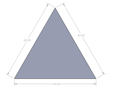

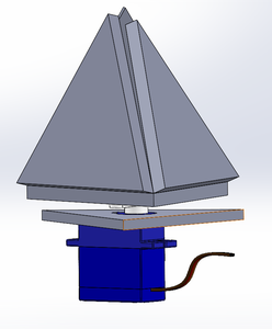

Cut five equilateral triangles of side 60mm.
Use four triangles to create a shape as in the figure 3.

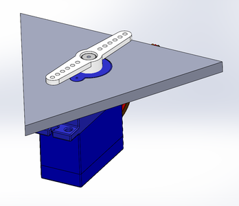

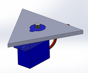

Trace the shape of servo head on the remaining triangle and cut it as shown in the fig. 4
Assemble the derived parts.

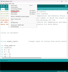

Download the Arduino code:
- Download the Arduino code from the GitHub repository or from the Google Drive link provided.
Install the Arduino IDE:
- Download and Install the Arduino IDE from the official Arduino website.
Connect the Cyclops:
- Connect the Cyclops to your computer by USB 2.0 Type A/B Arduino cable.
Upload the code:
- Open the Arduino IDE, go to the Manage Libraries tab and install the following library - DHTNEW Library by Rob Tillaart for DHT11 Sensor.
- Open all the .ino files in the Arduino IDE and navigate to final.ino file and select your particular board and port and upload the sketch.
