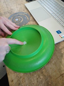

Step 2: Plate With a Bigger Edge: Attaching the Edge to the Plate
Adhesive velcro can be used to attach the edge to the plate.
Cut two strip of 7 cm from the hook side of the adhesive velcro. Attach those strip to the inside of the edge of the plate, across eachother. Cut away the excess velcro.
Cut a strip of the loop side of the velcro, with the same size as the circumference of the PVC pipe. Attach it to the top edge of the pvc pipe, closes to the cutt out parts.
Now you can attach the edge to the plate.

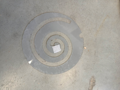

Step 3: Making the Learning Plates: Lasercutting the Parts
With a lasercutter the different parts of the learning plates (spiral, double edge, dashed line) can be made. In the attachment the used file is included. Use the elastic file holder as material to lasercut.
At the end you should have:
  • a long strip with hooks
  • 3 short strips with hooks
  • 2 spiral forms (left and right)
  • 2 round plate with cut outs

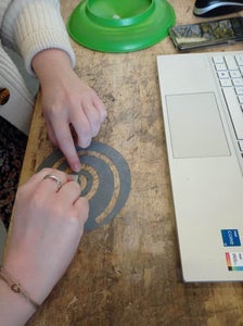

Step 4: Making the Learning Plates: Making the Double Edge and Dashed Edge
In the round plates holes are included. Use those to insert the laser cut strips in the round plates. The hooks ensure that the two parts are firmly put together. Now you can push the plate into the chinese plate (under the edge). This ensures that the tool is stuck in the plate.

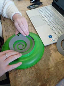

Step 5: Making the Learning Plates: Making the Spiral
Take the spiral form. Put a small piece of adhesive velcro to the middle of the bottom of the plate. Add the other side to the middle of the spiral. Now you can put the spiral form in the plate. Push the spiral form completely under the edge of the plate.
Step 6: Making the Learning Plates: Adding Visual Support
Use a permanent marker to indicate the movement the person has to make (see picture).
For the spiral the person has to follow the spiral form. With a marker you can also put a L and R, to clarify whether it's from left-handed of right-handed people (see picture).
For the double edge, the person has to stay in between the edge of the plate and the extra edge.
For the dashed edge, the person must move from the border of the plate to the middle.

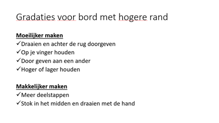

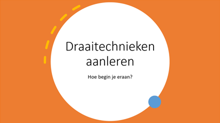

Step 10: Making the Learning Document
Attached you can find the learning document of the different plates. This document was made to clearify the learning process and make it easier or more difficult. This document can be used to adapt the activity to the person.
