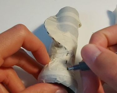

Cover the whole handle with tape.
Step 3:
Draw the line(s) you want to cut. It's best to cut on top of protrusions.
Step 4:
Cut the tape open
Step 5:

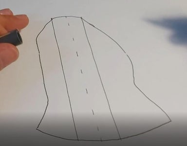

Try to lay the pattern flat on the paper.
Step 6:
Draw around the tape.
Step 7:
Choose a spot with enough space for the velcro. (+-2cm) Draw a line in the middle. This is where you have to cut this pattern piece for the velcro. This way you can open and close the sleeve.

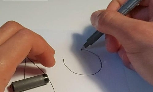

Step 8:
For the closed end of the pattern you just need to measure then end of the handle and add 2cm for the diameter of the circle you have to use for the pattern. Draw this circle on the paper.
