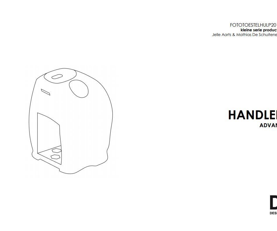

In 2012, Annelies Rollez, Cesar Vandevelde and Justin Couturon, designed a left hand cameragrip for Barts (Grimonprez) digital camera.
We reviewed the design and parametrized it so it can be made in a flexible production proces. This way the left cameragrip can be custom-made to the handsize of the user and the type of camera at a reasonable price.
We designed a simple system to measure parameters of the users camera. Moreover, we also measure the hand lenght of the user. This data is then imported in a CAD-model. It generates the necessary files to produce the parts with flexible production methods, such as 3d printing and lasercutting.
We also tried to translate the original idea, a custom made ergonomic grip, to a simple proces where the shape is 3d scanned. However it requiers specialized technology and knowledge to translate this raw data to a usable model. This raises the price of the grip substantialy. Future versions of software like Siemens NX promise automatic importing of raw scan data so maybe in the near future this will be viable concept.
