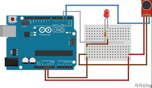

Step 1: Connect the Circuits
Image from: https://www.instructables.com/Arduino-Sound-Sensor-with-LED/

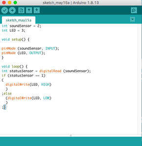

Step 2: The Code
https://create.arduino.cc/editor/3023lillian/8464e594-2145-4dfa-bf6c-04df6c6a7c70/preview
