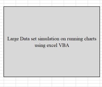

Introduction: DATA ANIMATION USING EXCEL VBA
About: Power plant operations engineer
Some times in oder to visualize multiple data set we need to have an animation of data trends. This shows how these data interacts and their interdependancy. In this intructable i am showing how this can be done on excel using VBA .
To simulate your data set you just need microsoft excel.
