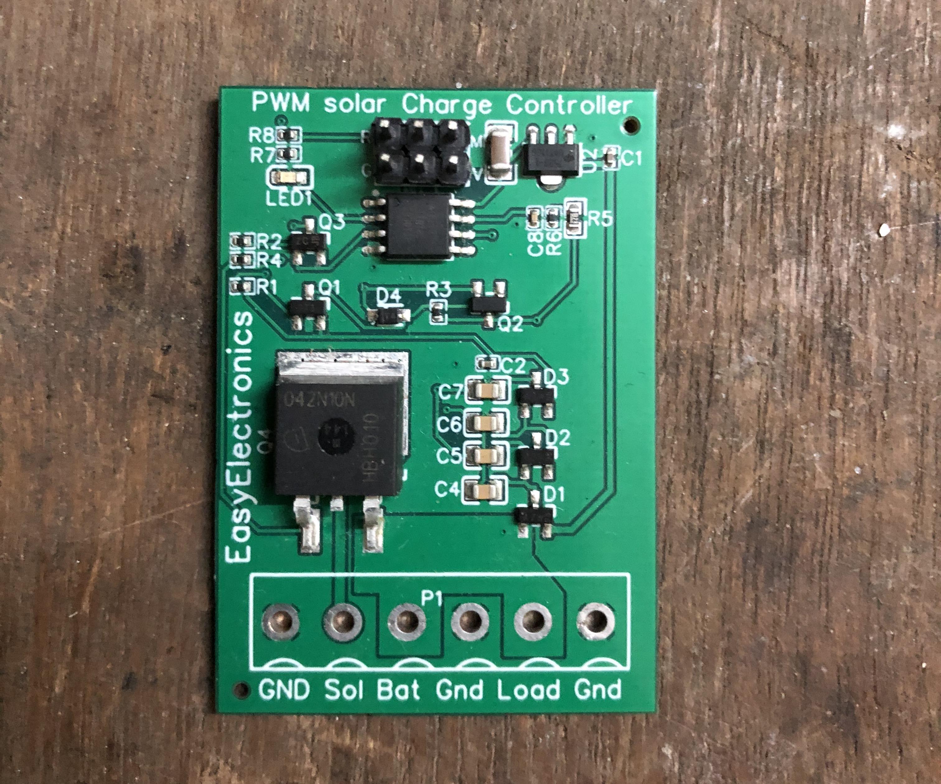

Step 2: PCB Design
I have used EasyEda to design the 2-layer PCB.
If anyone wants i can always post the gerber files for you.
Most important design consideration to be kept in mind is that the ground terminals of the diode,caps and IC should be as close as possible.
Also the track length of Output pin of IC (pin 2) to inductor should be as short as possible.

Step 4: Assembling and Working
Before ordering the PCBs, always make sure that the layout and circuit is working.
I tested the circuit on perf board and then on home etched PCBs and then I ordered the PCBs.
In my circuit I have added additional points for PIN 4 and 5 to be connected to arduino or other MCU.
Pin 5 can be used as an on/off switch (active LOW), so when PIN 5 is grounded the buck converter is on and when PIN 5 is above 1.8V the converter is off.
PIN 4 is the feedback pin and with the help of PWM from arduino/MCU we can control the output voltage using an additional resistor at the resistor divider circuit.
At the end I would say that the LM2576 or LM2596 are one of the most easy buck converter IC to work with and are easily available at local electronics shop and online.
Also this IC is very forgiving and works with poor designed layouts.
I would recommend using heatsinks on IC to increase their life.
