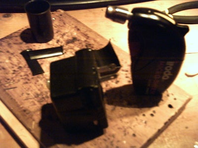

Step 1: Let's "Trash" It

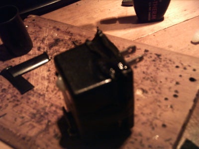

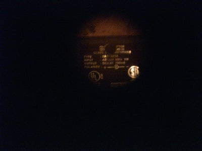

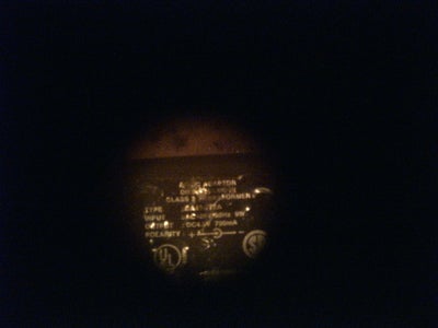

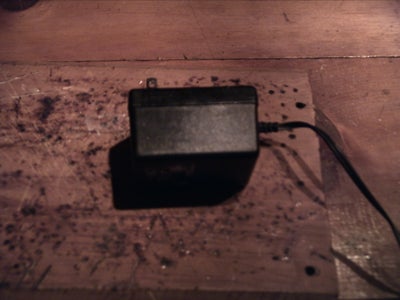

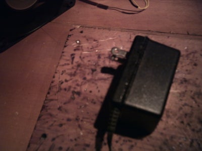

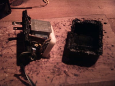

We need to take the supply apart, but first we need to test the "true" voltage being supplied. The wart I had said the output was 4.5V (you can barely make it out in the first picture), but when I tested the output, it was at 9V (which would definitely fry the 4V LED). I suggest unplugging the wart and keep it attached to the multimeter until the transformer is drained of its juice.

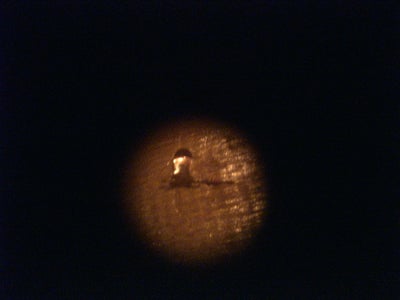

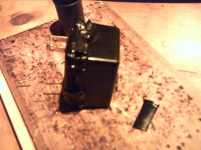

Now that we know the output, we can take it apart. There are several ways to go about this.
1. You could put the supply into a vice and squeeze it until the seams break.
2. You could use a hack saw to carefully cut your way into the supply.
3. Or you could do it the unsafe way, by melting the seams using an old soldering iron (technically wood burning) that the tip has been murdered from neglect.

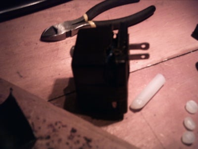

Yes, I went with choice number 3 (not the wisest idea, but it worked and was fast). If you choose to also do this version, I beg of you to take proper precautions beforehand (vented area, goggles, etc). Melt only deep enough around the entire supply to give you enough leverage to use the screw driver to pop the cover off the rest of the way.

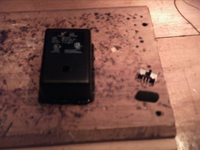

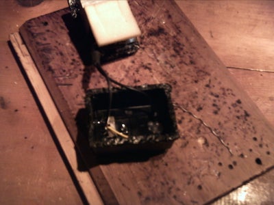

Now that we're inside, we need to figure out how we want to hook up our circuit and where everything will be located.
The case:
First, we'll make a hole for the LED using a drill (or in my case an iron). I made mine near the top/center.
Second, the hole for the switch using the same method. Made mine near the bottom/center.

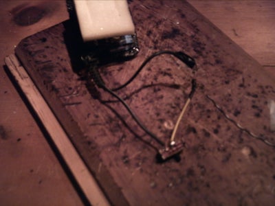

The circuit:

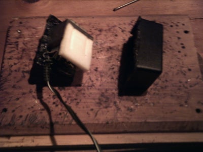

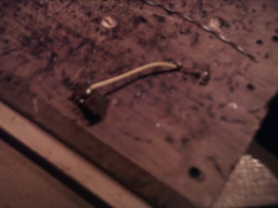

1. Solder the resistor onto one of the legs of the LED (doesn't matter which one, as long as the current goes through it).
2. Solder the resistor to a wire.
3. Solder the wire to the switch.
That's it for the circuit until the next step...

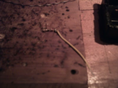

Step 3: Rest of the Circuit and Case Fit

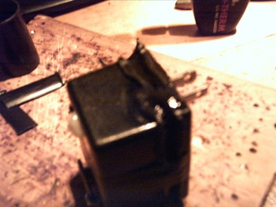

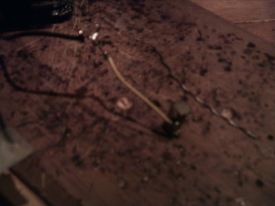

Now we can trim the DC supply wires down to the length we need (about 3 inches) and bare the ends (make sure they don't touch).
Depending on which side of the LED is positive (shorter element in LED) and which is negative (larger element in LED), solder the DC supply's wires onto/into the circuit accordingly (Negative goes to the negative side, positive to the positive side). In my case, I soldered the positive to the switch and the negative to the LED. Wrap the wires up with some tape.

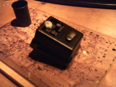

Get your hot glue gun and glue the pieces into the holes we've made in the cover. Let it harden. Put a dab of hot glue over the LED to help diffuse the light.
Now we get to put the puzzle back together again. Carefully fold the wires into the case (leave absolutely no wires outside the case) and press the cover back onto the base. In my case I had a small gap, but it doesn't matter cause it's going to be "welded" shut soon...

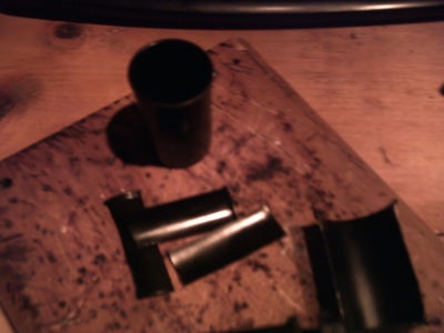

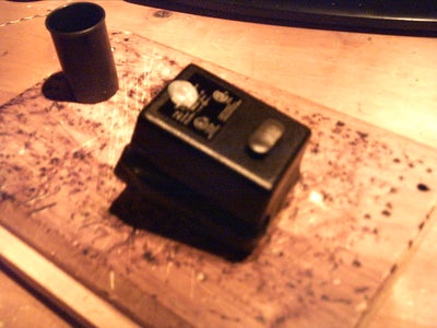

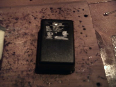

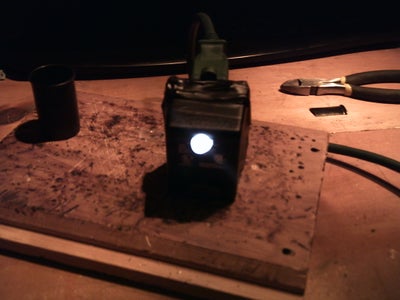

Take the film canister and cut long strips out of it. Using your heat gun (or flameless heat gun), melt the strips into the sides of the supply (see pictures).
Once all the sides have been plastic "welded" shut, you can add an extra protection layer using electrical tape.

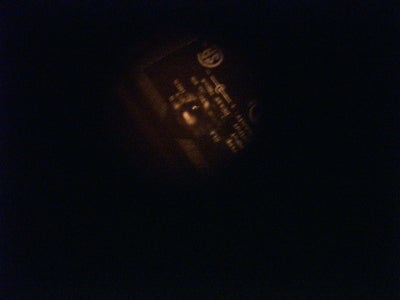

Now go plug it in and hit the switch. It's a robust night light (you can also use it for a 10 second flashlight. More time if you use a larger supply voltage).
The two things I'd change about it later is:
1. More LED's (I only had one white LED at the time)
2. A stronger switch like a toggle (sister bit the other one off. Can still turn on and off using a toothpick, but unable to reattach switch without taking it apart. Lucky for her it wasn't a bulb night light)
