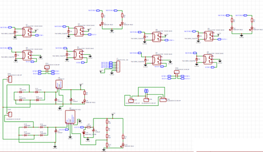

Step 1: SCHEMATIC DIAGRAM
Here we will see the schematic diagram made in the EASYEDA software with their respective values
Step 2: FUNCTIONING
The direction of rotation is controlled by means of a circuit known as 'H-Bridge', which is already integrated into the PWM controller. This is how it is known for its shape similar to the letter H.
First we will energize the system with 220VAC because from the same PCB we will control the 15VAC transformer and in turn a switch is integrated to turn the PCB on and off
After turning on the transformer we will use two voltages 12VDC and 15VDC for this they have to go through a wave rectifier and a ripple filter to pass from AC to DC and thus we will obtain the established voltages
a 12VDC voltage will serve us for the control stage and make them switch to the 12VDC relays and the 15VDC will serve us to drive the DC motors and reverse rotation
It should be noted that we will use a pedal to activate the DC motors through NO buttons, which in turn are connected with a cable to the PCB and thus control the direction of rotation of MOTOR 1 and MOTOR 2.

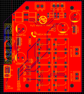

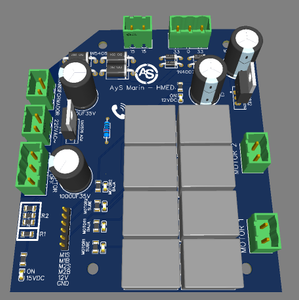

Step 5: EASYEDA
This project was made in the Easyeda software as we can see the tracks and the 3D image of the project working perfectly are no difficulty
