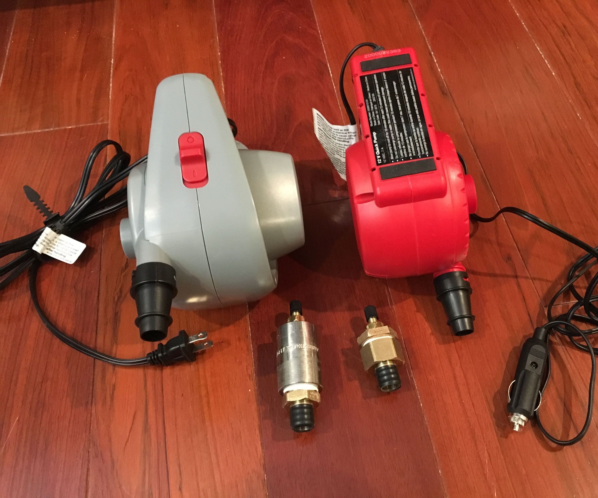

I bought Extremeaire Air compressor for my truck. It has a superb motor, solid cable and top quality. However, it has two problems. It does not have fuse box for safety and switch to turn it on and off. Once hooked to car battery, you will see an electric spark and motor is running. It is just too dangerous for me. Manufacturer advised me to use quick connector to switch it on and off. The quick connector is very hard to pull apart and hookup. It is simply not designed for switching. Also this unit does not have fuse box to protect circuits. If shorted, it will damage car battery right away. Anyway, i need a fuse box and switch for this superb air compressor.
