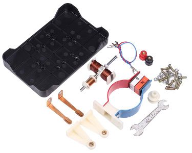

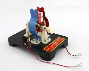

Introduction:
This is a simple permanent magnet DC motor model to demonstrate the DC electric motor working principle.
It will rotate like a real electric motor ideal for school scientific projects or physics teaching.
Parameter:
Model:J24018
Working voltage:DC 3.0V-6.0V;
Usage: Study magnetic lines of force;
Magnet size:22*20*20mm(0.86*0.79*0.79 inch);
Magnetic flux density:>=72mT;

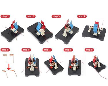

Step 1: ​Install Magnet Bracket on the Plastic Seat

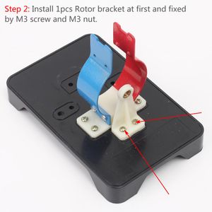

Step 2: Install 1pc Rotor Bracket at First
Step 3: Install Another Rotor Bracket and Rotor/commutator/armature Coil
Install another rotor bracket and rotor/commutator/armature coil and fixed by M3 screw and M3 nut.
Step 4: Install Pulley on the Rotor.
Step 5: Bend the Angle of the Electric Brush

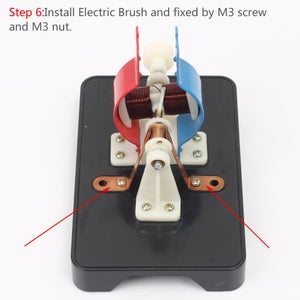

Step 6: Install Electric Brush and Fixed by M3 Screw and M3 Nut.

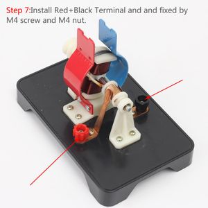

Step 7: Install Red+Black Terminal
Step 8: Install Permanent Magnet.

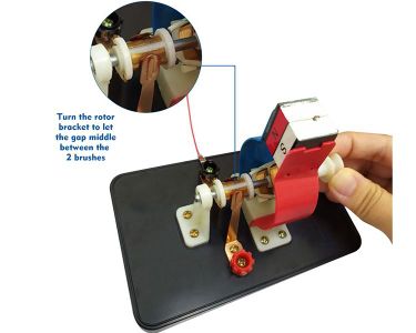

Step 9: Connect to the Cable on the Terminal
When you finish the motor assembly, please turn the rotor bracket to let the gap middle between the 2 brushes.
And then connect to the cable on the terminal and then connect it to DC 3.0V-6.0V power to do a test.
Please Note:
1. To avoid the short circuit, two electric brushes never touch the commutator segment.
2. Its working voltage is DC 3.0V-6.0V.
