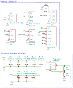

In the third image we see, on the top side, all the connectors used. Most are used to send important data to our data acquisition system, but two 3 pin connectors are used to receive data relative to the current measured vehicle speed, measured with a Hall sensor, and the current desired vehicle speed, which our pilot adjusts with a potentiometer.
On the bottom side we see our voltage regulator, it takes in 24V from both batteries in series, requires two resistances (200Ohm and 600Ohm) to adjust the output voltage to 5V, and capacitors of various values (10micro Farad and 0.1micro Farad) on the input and output to filter any noise the signals may carry.

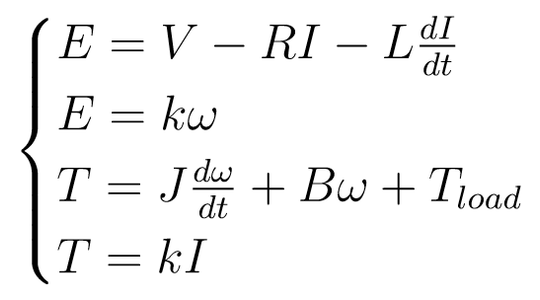

The system of equations in the third image describes how the mechanical component interacts with the electrical in a DC motor.
Matching the torque and velocity on each motor (using the coupler), and knowing the constants R, L, k, J and B for both cases, with just a few measurements, of the system, it is possible to calculate all the relevant information.
For example, imagining we know the torque the car and the driver apply on the motor on a certain point of the track, by adjusting the rheostats, we are able to obtain the current draw curve on the controller for variable speeds under those conditions.
