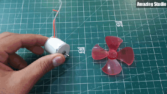

Step 5: Making of Motor Shell:
After cutting all the pieces, just put them on each other and join together using super glue. Make a small hole in center of the round sheet.

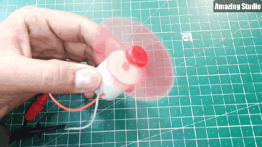

Step 10: PVC DC Motor:
Now close the outer round sheet covering and it is ready to use, supply this with a cell of 1.5 or 4volts. Place the rotor and then the back sheet, glue them properly.
Step 11: Working:
My motor is taking amps on a voltage of 1.5 volts without load. Using this with some modified fan, the current consumption goes above amps on volts.
