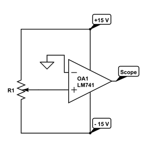

Step 3: The Comparator
The circuit above is called a comparator, and essentially serves to demonstrate the action of golden rule number one. It is the first op-amp circuit we built in our lab. In this case we have no feedback, and the potentiometer lies between +15V and -15V. Note that the op-amps power source is shown in the circuit, thought it will not be in others. In this case we can wipe the potentiometer so that that V+ sees anywhere between +15V and -15V. According to the rule, V_out=A(V+ - V-)=A(V+ - 0V)=A(V+), and our output will read +15V if we wipe the potentiometer such that it inputs a positive voltage to the non-inverting input. On the other hand, if we wipe the potentiometer such that it inputs a negative voltage into our non-inverting input, we will see -15V out. This circuit is aptly called a comparator because it allows us to compare any signal at our non-inverting input to the signal at the inverting input. Based on whether we see a positive or a negative rail, we can use this circuit to easily determine the sign of an unknown voltage. As an extension, we can easily imagine setting V- to some nonzero reference point, and inputting some signal, possibly an alternating one, to V+ for more interesting "comparisons".
