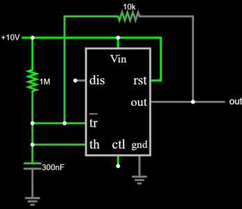

Step 2: Setting Up the 555 Timer Circuit:
●Place the 555 Timer IC on the breadboard.
● Connect pin 8 (Vin) and pin 4 (reset) to the positive rail of the power supply, and
pin 1 (Ground) to the negative rail.
● Connect pin 2 (trigger) and 6 (threshold) together.
● Attach a 1MΩ resistor between pin 2 (trigger) and the positive rail.
● Place a 390nF capacitor between pin 6 (threshold) and the negative rail.
● Connect pin 2 (trigger) and pin 3 (OUT) with a 10kΩ resistor.
● The output at pin 3 (OUT) should now generate a square wave with 50% duty
cycle. Use an oscilloscope to confirm the square wave output.

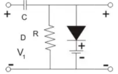

Step 4: Constructing the Clamper Circuit:
● Place a 1uF capacitor in series with the output of the LC filter.
● Attach a 10kΩ resistor from the junction of the capacitor and the LC filter to the
positive rail.
● Verify the output using an oscilloscope. Expect to see the waveform centered
around 0V.

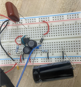

Step 5: Physical Assembly and Testing:
● Use the circuit diagram as a reference for placing components on the
breadboard.
● Double-check all connections for accuracy.
● Power the circuit and use an oscilloscope to observe the output. Notice that the
bottom positive rail is provided with 5V DC power supply, and the top positive rail
is provided with 10V DC power supply.
● Verify that the output matches the simulation, showing an approximately
sinusoidal waveform centered around 0V.
