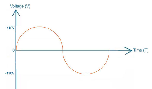

There are two types of inverters:
- Pure Sine Wave Inverter
- Modified Sine Wave Inverter
A pure sine wave inverter is more efficient and powerful than a modified sine wave inverter. It is used to provide power to high-energy consuming electrical devices like printers, computers, etc. This inverter has the best waveform with the lowest THD of about 3%. However, It is the most expensive.
A modified sine wave inverter is cheaper and less efficient. It is used to power a limited number of appliances. They are not used to provide power to air conditioners, or microwaves as they are not much powerful. These inverters provide a better power quality (THD~ 45%) and are suitable for most electronic equipment.

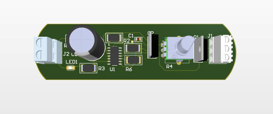

Step 4: Schematic
Using the Altium Designer, I have designed my PCB board. At first, I created a schematic diagram in Altium then I uploaded my schematic file online on Inventhub. I have designed symbols and footprints of each component and then I have uploaded them to a components management library on Inventhub. Users can view or download the schematic file. They do not need to create symbols and footprints instead they can easily download the files from Inventhub to implement my design.
Step 5: PCB
After creating the schematic diagram, I converted my schematic file to a PCB file. In the PCB file, I can design my board and can view it in 3D. I have uploaded my PCB file on Inventhub where I can view my board in different layers and can focus on a specific layer of a board by disabling others.
I can also view the changes I have made in my design at different levels and can focus on a specific component in my ‘view changes’ section on Inventhub. The manufacturers can download my PCB file with the latest changes I have made in my design and can fabricate my PCB board.
