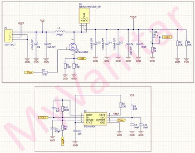

Figure 1 shows the schematic diagram of the DC to DC boost converter. As it is clear, the heart of the circuit is the UC3843 chip [1].
Step 2: Figure 1 Schematic Diagram of the UC3843 DC to DC Boost Converter
C1 and C2 have been used to reduce the input noises. L1, D1, and Q1 build a boost conversion network. L1 is an 8A to 10A 100uH inductor. D1 is the MBR20100CT [2] Schottky diode (two parallel diodes in one package). Q1 is the IRFZ44 N-Channel Mosfets [3]. The ON resistance (RDS(ON)) of the Mosfet is just around 28 milliohm and it can handle up to 50A at 25C. So, these characteristics make these components a good fit for this project.
IC1 is the controller of the boost converter circuit. According to the UC3943 datasheet: “The UC3842/UC3843/UC3844/UC3845 are fixed frequency current-mode PWM controller. They are specially designed for Off-Line and DC to DC converter applications with minimum external components. These integrated circuits feature a trimmed oscillator for precise duty cycle control, a temperature compensated reference, a high gain error amplifier, a current sensing comparator, and a high current totem-pole output for driving a Power MOSFET.” C3, C4, C5, C6, and C7 are used to reduce the output noise.
Usually, a boost converter output is noisier than a buck converter, especially by using discrete components. A single-chip buck/boost controller is less noisy, however, the output voltage and current of these controllers are limited. R1 is a 10K multiturn potentiometer that you can set to adjust the output voltage. You can increase the output voltage level by decreasing the R5 value. The output voltage is determined using this formula:
Vout = 2.5 (1 + R1/R5)
So as it is clear when R5 is 1K, then the maximum output voltage is somewhere between 27V to 28V. if we decrease the R5 value to 820R or 680R, then the maximum output voltage would be around 32V to 33V or 39V to 40V. I don’t recommend increasing the output voltage more than this because the voltage + noise level might cross the rated voltages tolerances of the capacitors (50V), which of course might be lower than 50V in practice (due to manufacturing tolerances). R2 and R3 have been placed in parallel that builds a preliminary load to help to stabilize the output voltage.

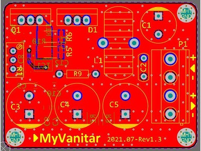

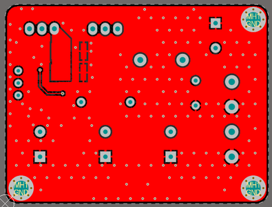

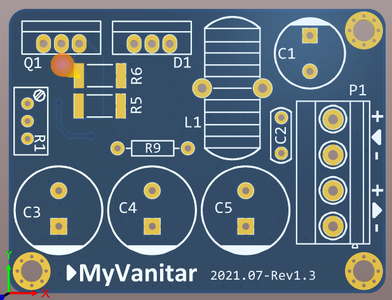

B. PCB Layout

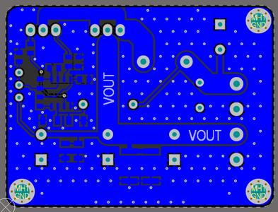

Figure 2 shows the PCB layout of the design. It is a two layers PCB board with a mixture of SMD and through-hole components. A view from the top layer, bottom layer, and silkscreen and solder mask (top layer) have been all included in figure 2.
Step 3: Figure 2 the PCB Layout of the DC to DC Boost Converter

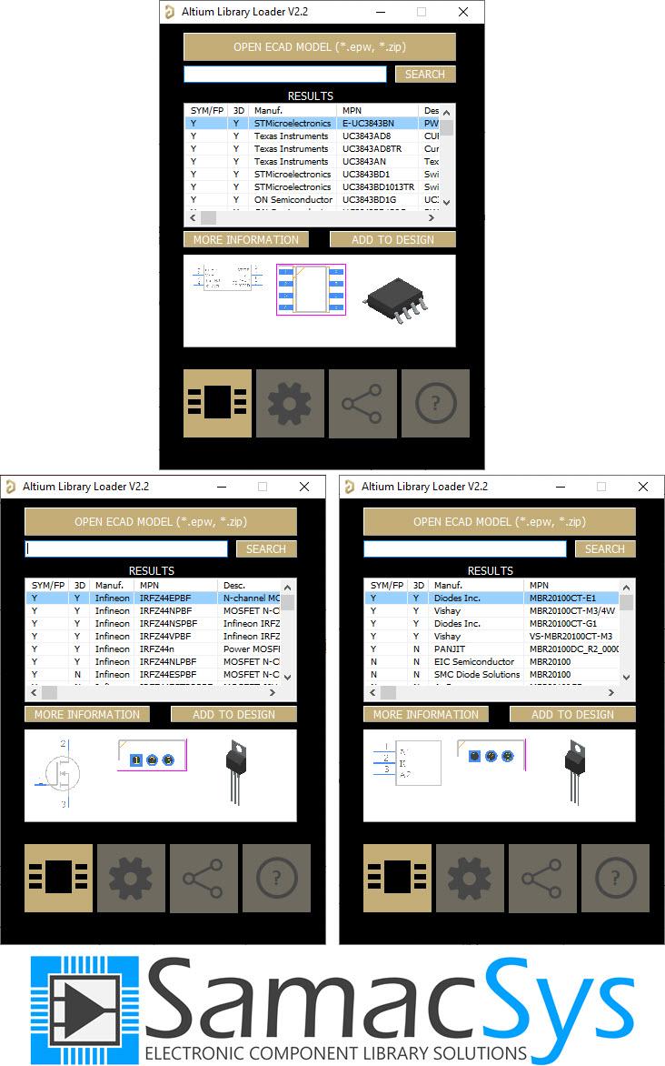

Specifically, I used the SamacSys libraries for IC1[7], Q1[8], and D1[9] which you can consider in the references. Another option is to download the component libraries from componentsearchengine.com and import them manually. It’s up to you. Figure 4 shows the selected components in the SamacSys Altium plugin.

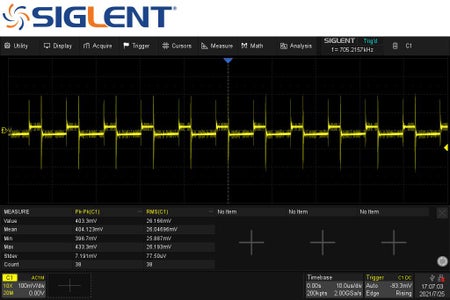

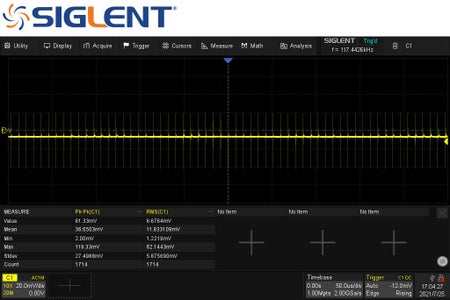

Figure 6 shows the output noise of the boost converter under no load. I used the power analysis feature of the Siglent SDS2102X Plus oscilloscope [11]. Of course, you can use the cheaper Siglent SDS1104X-E oscilloscope [12] as well, however, the plus one is something beyond. It is a role model device. Some long inductance spikes can be seen in the waveform that is unlikely to come from the output line. So I kept Vrms as an indicator.

Figure 7 shows the output noise of the DC to DC converter under a 2A load. The same as above, I don’t think these longs spikes are really coming from the supply. When I move away from the probe, these spikes vanish significantly. I recommend you to use some capacitors just as close as possible to your load.

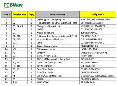

Figure 8 shows the bill of materials of the circuit. L1 is a 47uH to 100uH inductor that you can build or purchase. I built it myself, so I can not offer any specific part number for that. However, make sure that your inductor can tolerate currents of at least 8A to 10A. You can use a 1mm copper wire and a toroid ferrite core. The used drill size for the inductor footprint is 1.3mm.
