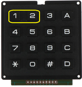

The 4x4 matrix keypad is available on eBay and Aliexpress. Be careful when soldering it, because the edge connector is a single sided PCB and very fragile. It is easy to lift a track by overheating it. It also does not seem to take solder well so use plenty of flux. As you can see in the picture, the soldering on it is horrendous.

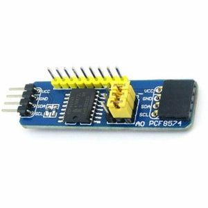

I2C GPIO expander PCF8574 is also available on eBay/Ali. It has 9 pins which conveniently align with the 10 in the keypad. The hole nearest the D-key is left clear (see picture). Note in the picture how it is mounted with the pin tips only just coming through the keypad board. This will allow the keypad to be mounted through a hole in a box without the PCF8574 fouling on the case.
The I2C address of the PCF8574 can be set using the jumpers on the board. Set the jumpers as shown in the picture. Remember the LCD backpack, this PCF8574 device and the INA current monitor (if used) all must operate on different addresses, and these must match those set in the software. When the unit boots, if you have it connected to a serial port monitor, you will see it searching for and reporting the I2C addresses that it finds.

The software has been updated to recognise certain dual-key presses. Pressing 1-2 together will activate EMERGENCY STOP. Pressing 3-A together will activate MODE. Together these allow you navigate the various menu screens in the software.
The hardware based alternative is to wire a pushbutton between P6 on the backpack and ground for ESTOP, and between P7 on the backpack and ground for the MODE button.
