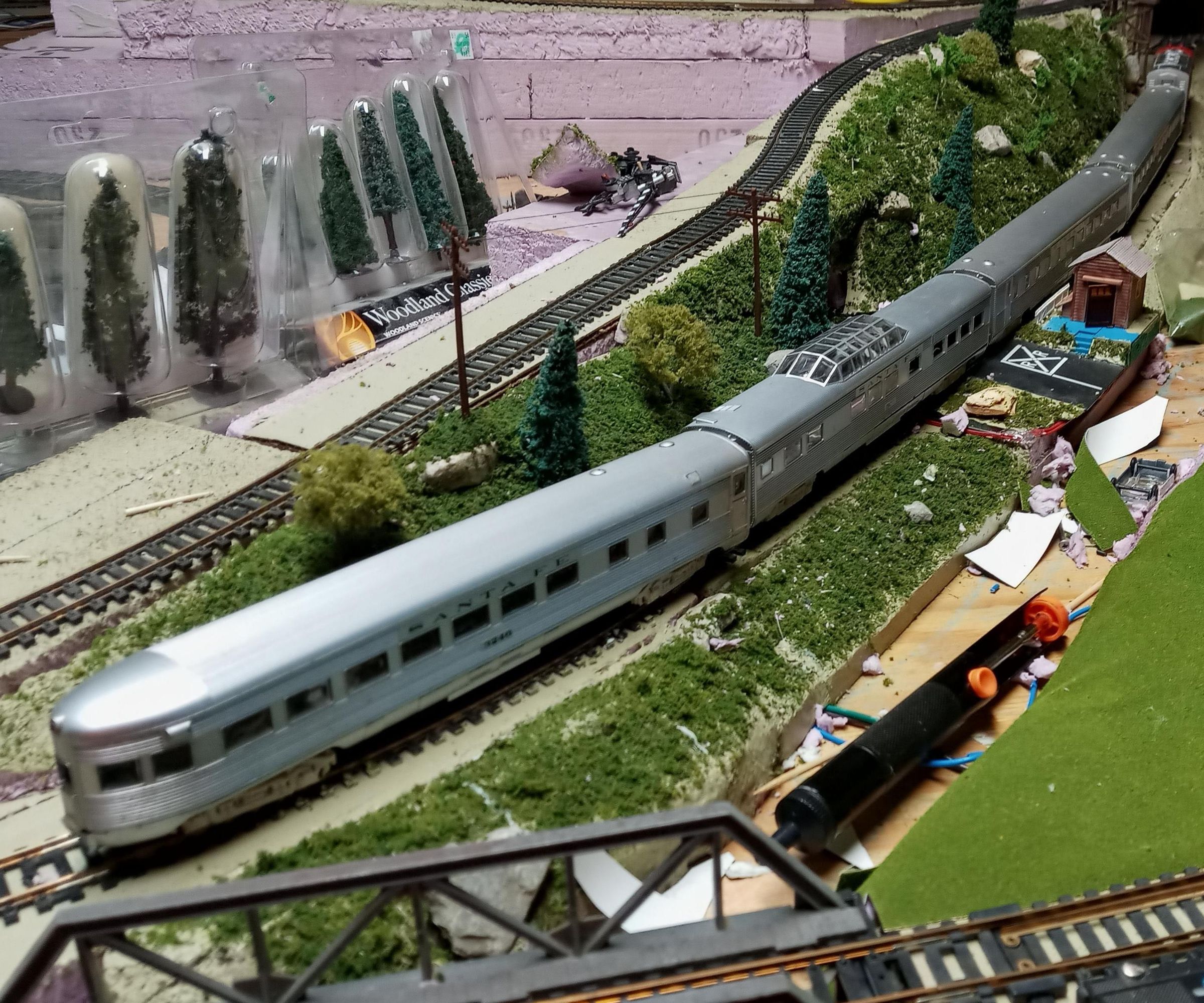

I have used a couple of controllers on my layout. These being the gold Tyco variable voltage controller and the white Bachmann controller. The Tyco had to go because it uses variable voltage instead of PWM to control motor speed. This results in poor operation at low speeds. The Bachmann is much better and I think it might do PWM but does not solve the issue of controlling multiple trains on the same track. Looks like we need a DCC system. But those are expensive to move into and all my trains are old and do not support DCC. I also don't like the user interface on DCC. I want something much simpler so it looks like I get to develop my own system. I have made an attempt at this before, check that system out at PPM cab Control. Next, I will walk you through how I solve the problems just outlined.

See the system at work in the video above.
I think this is a very adaptable system and hope to add some automation failsafe on the train to make the system dummy-proof so anyone can take the wheel without breaking something. In the end I think it will go far beyond regular DCC control. As stated before if you like this please vote for it by clicking the vote button below. Also if you want to see more of my projects subscribe to my account so that you can catch the new stuff coming soon.
