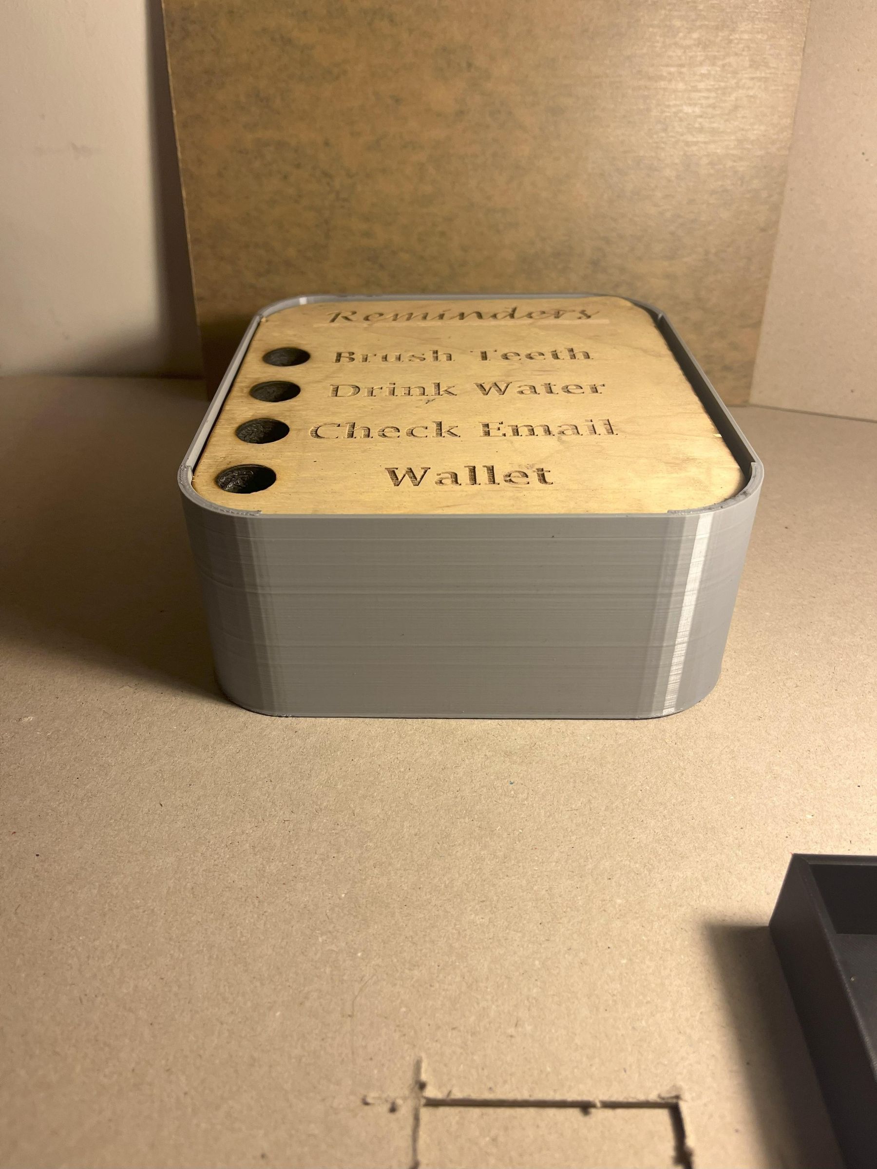

Step 2: Modeling Enclosure and Display
The 3D modeling and printing aspect of this project is fairly minimal. The front display has the names of the characters engraved in the 3D print and in the small piece, you see if the needle points to the player currently in initiative order.
For the pointer,
-Make sure you measure the end of the Stepper motor accurately so that the needle points move with its rotation and aren't damaging it to get it on.
For the display,
-This display was fairly easy for me to model the only trick part was getting the names engraved and creating the side pieces so the top could click into the bottom piece.

Step 4: Final Results
With that, you should have the following working Arduino-powered D&D Initiative Tracker!!!! I had a lot of fun doing this project it was exciting and a lot more code-heavy than I anticipated. Overall an awesome project would have done the display as a laser cut top if I had thought ahead, 3D printing engraving(esq) words did not work super well. Though it got the job done, I think a laser-cut top would look a lot nicer.
