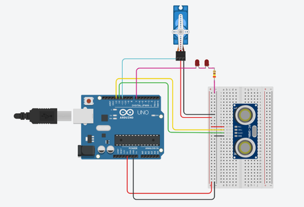

On the photos upload, we can observe how the circuit has been connected and its schematic view. Moreover, there is a video to show how it looks like finished.

Step 2: ELECTRONIC HARDWARE
In order to make the death come alive and move, we must recreate the circuit of the Tinkercad image, in this way, along with the programmed code can be achieved.
First we have to take several cables to be able to connect the circuit in a protoboard. We will connect the motion sensors, the leds, we must apply the necessary jumpers and connections to have all the required GND and 5V inputs.

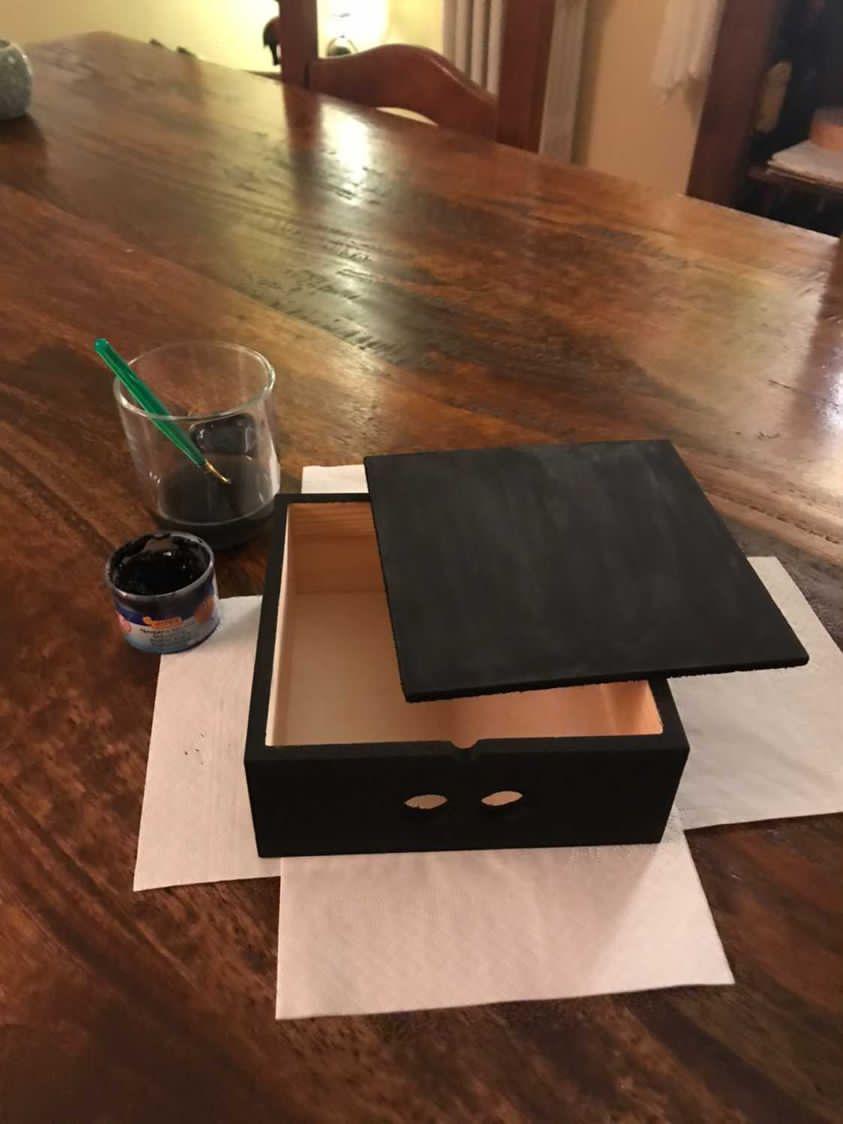

We got our box and slowly started to bring in our electronics. To achieve our goal, we drilled the necessary holes in our box to implement our electronics inside.
In order to put our servo properly, we made a hole in the lid of the box of its exact size where it was glued with silicone, but with the help of adhesive tape we fixed it so that it does not move or fall.

To make our DEATH more real, we painted the base black and decorated it to simulate a graveyard.
