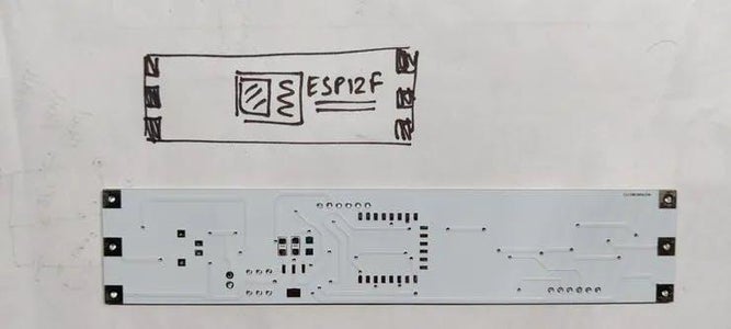

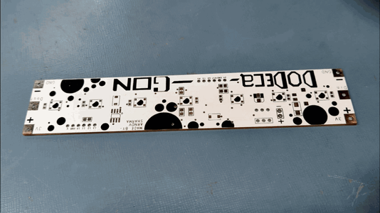

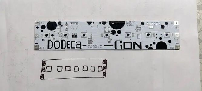

Step 1: CUSTOM CIRCUIT From OLD PROJECT

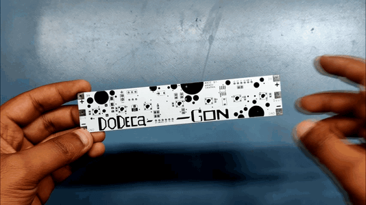

To make this RGB Lamp, I used one of my previous project's PCB which was this-
https://www.instructables.com/Dodecagon-Portal-Pro...
In this project I've used two circuits, one is the mainboard and another one contains 7 WS2812B LEDs.
Mainboard has ESP12F Module hooked up with WS2812B LEDs. The mainboard generates the signal for the first WS2812B LED, through NZR communication mode, the first pixel obtains the data from ESP8266 via DIN Port and then sends the 24bit data to the second pixel via its DOUT Port.
Main Board Contains 7 PCBs so when the data reaches to 7th pixel, we add another PCB onto the main board which adds 7 more pixels to this setup, the data is then transferred from the first PCB to the second PCB
the Second PCB doesn't have an ESP12F module soldered on it, it's just a breakout for 7 RGB LEDs.
So in total, there are 14 RGB LEDs used in this lamp, 7 on the first board and 7 on the second.

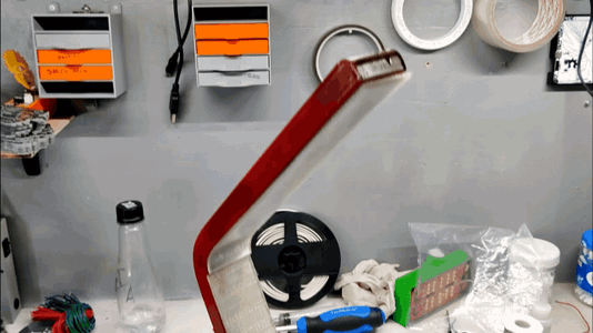

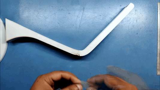

I've prepared this model in fusion360, the goal here was to make a lamp that looks different than a traditional lamp and it would feel futuristic, so I just use a curved line shape and modeled the lamp based on that curvy shape.
Because of the lamp height, I prepared a wide base to support the length and height of the lamp so the setup would maintain a low center of gravity. After finalizing the lamp, I exported all the files and prepare my printer for a 48-hour print job.
Step 5: 3D PRINTING
This lamp contains 6 different parts, well technically speaking 4 but I had to divide the TOP Body and its diffuser into two parts as they were too big for my printer's built surface.
All parts were printed with White PLA except for diffusers which were printed with transparent PLA.
Step 6: Print Setting and Few Edits That I Had to Make

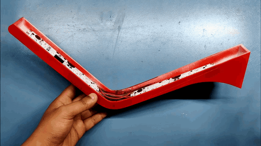

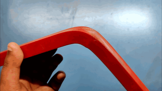

I used a 20% infill with supports, 0.2mm layer height, and a 0.5mm nozzle. 0.5mm Nozzle helped a lot in reducing the print time.

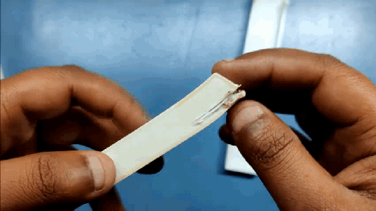

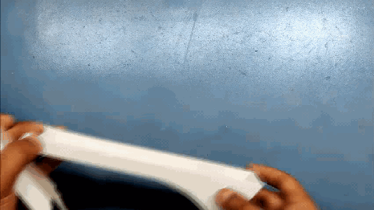

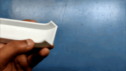

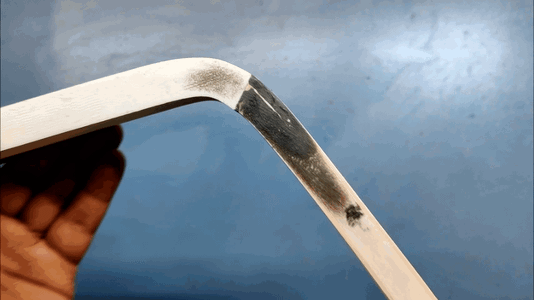

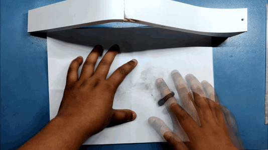

After Printing two parts of the TOP Body, I found out that one of the TOP Body Pieces has warped a little bit.
I could print another part but doing that would be a waste of time so instead, I cut down the warped piece from one side and bent it in the opposite way of warping.
Then I use fiber tape to hold the two pieces together and use super glue to attach the TOP two pieces.

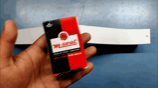

Superglue will permanently join two pieces together but to fill the gap between the edited piece, I used epoxy putty.

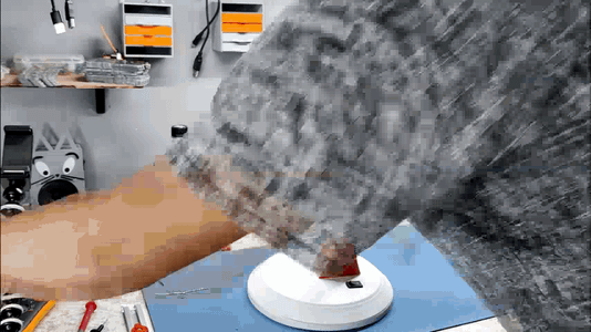

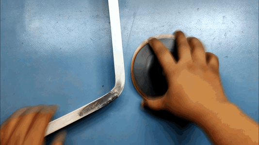

Step 7: Filling the Joint With Epoxy
I mixed the hardener with epoxy and apply it to the joints.
the key here is to apply the epoxy in between the spaces and then smooth the surface with a little bit of pressure with fingers.
After letting it dry for an hour, I used a sanding tool to sand the excess putty off from the surface and make the surface even and smooth.

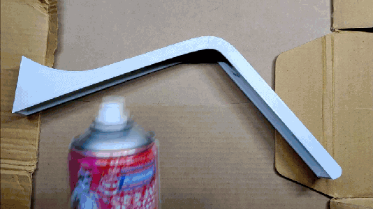

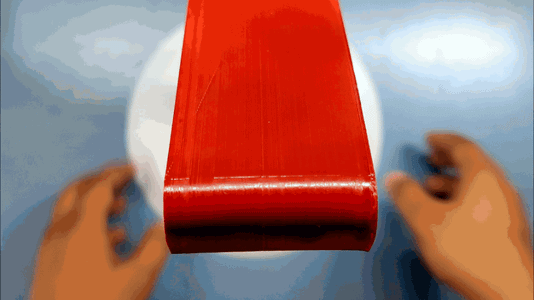

Step 8: ​PAINT JOB
Because of the Epoxy, I had to paint the top body to make it look better.
I used Metal Spray paint for this process and only sprayed the TOP Part and let it dry for 10 hours so the paint would completely dry up.

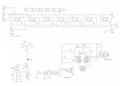

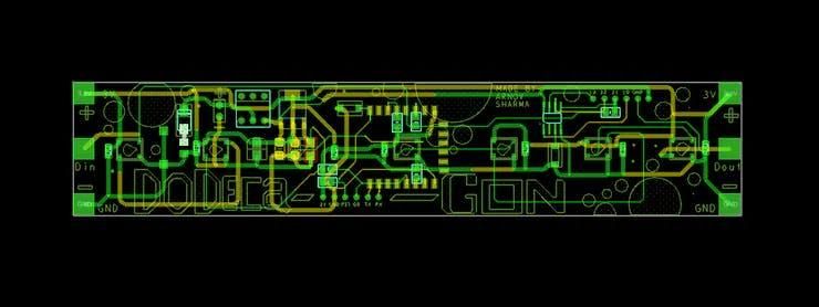

Step 9: CIRCUIT
Here's the schematic of the PCB that I'm using.

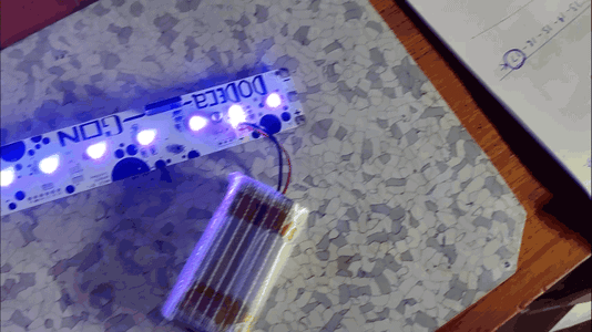

This circuit is pretty simple, there's a Minimal ESP12F setup along with an Attiny85 Setup on one side. both are connected with Neopixel LEDs, we can add either of those two setups on this circuit to drive 7 Neopixels. I've added an AMS1117 Voltage regulator to regulate voltage from lithium cell which is 4.2V to 3.3V for ESP12F to operate.
Step 10: ASSEMBLY #1

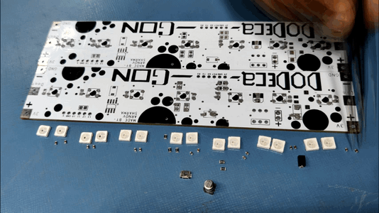

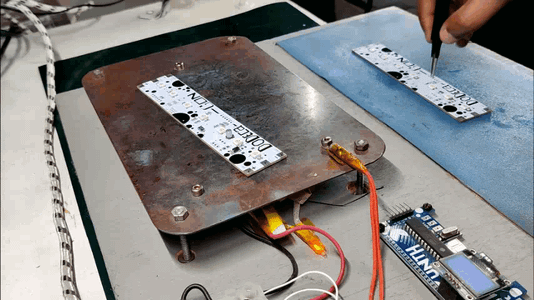

To Prepare the first PCB which would be this Main Board, I first applied solder paste to each component's PADs and then pick and place each component in their assigned place in the right order.
Step 11: ASSEMBLY #2
After adding components to their location, we carefully lift the PCB and put it on an SMT hotplate.
I'm using my DIY SMT Hotplate, learn more about it from here-
https://www.instructables.com/DIY-SMT-Hotplate-Pro...
Hotplate heats the PCB from below up to the solder paste melting temp, as soon as the PCB reaches that temp, solder paste melts and all the components get soldered to their pads.
we lift the PCB and then place it on a cooler surface for a little bit, to cool down the heat of PCB.

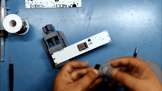

Now we need to add ESP12F on the bottom side with a Hot Soldering station because we cannot use our hotplate for this task.

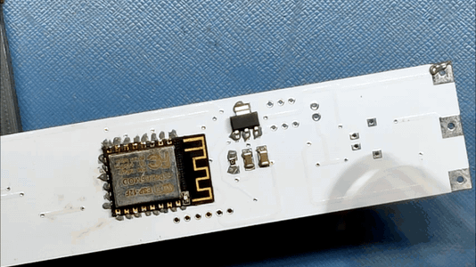

Step 12: ASSEMBLY #3
On the Bottom side of the Mainboard, I added solder paste to all components pads, then I placed ESP12F in its place and then add the AMS1117 Voltage Regulator along with 10uf Cap, 100uF Cap, and 0ohms Resistance to their pads one by one.
Then I used Hot air soldering station to melt the solder paste and solder all the components on their pads.
I didn't use hotplate reflow here as on the TOP side of the board there are LEDs and components so I only had two choices here, use a soldering iron or use a soldering air station.
At last, we add the THT Programming header pin on the Main Board and the circuit would be completed.

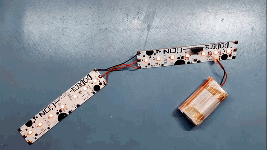

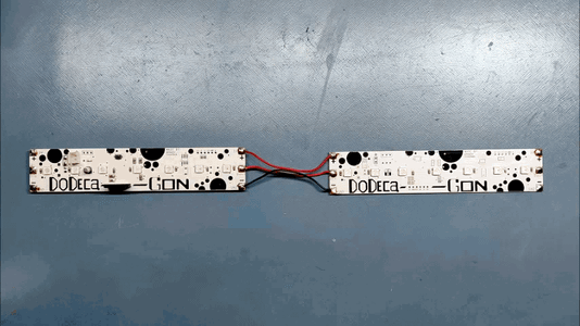

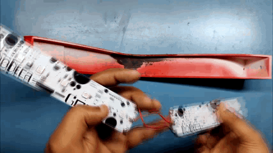

Step 13:

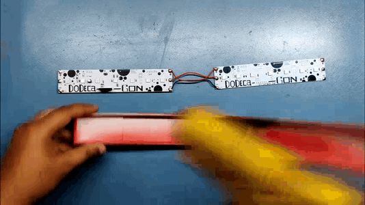

In the end, I added two PCBs together by connecting their Pads with wires in this config-
  • VCC of Mainboard to VCC of Second Board
  • GND of Main Board to GND of Second Board
  • Dout of Main Board to Din of Second Board

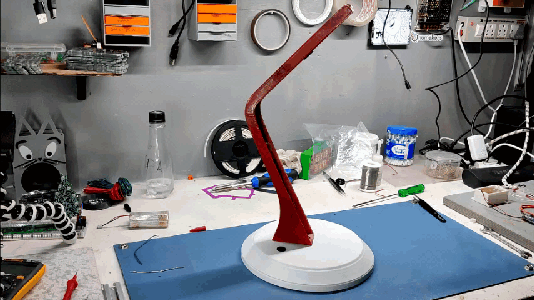

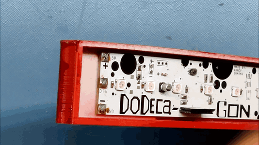

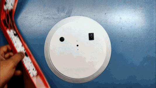

Step 15: FINAL ASSEMBLY #1

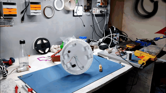

As for the final assembly, we start first by adding the circuit into the TOP Body by adding hot glue on the body and then placing the circuit onto it. dont worry, the circuit won't heat up and melt the glue.
Step 16: FINAL ASSEMBLY #2

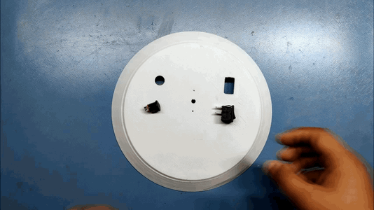

then we add a rocker switch and 5mm Barrel DC Jack on their provided slot and hole. Rocker Switch is to turn ON or OFF the mains power and DC Jack is for Charging the Lithium Cell.
after this, we screw the TOP Body onto the Bottom Body with M3 Screws. Now we prepare the wiring of this whole setup.

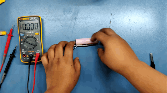

As for the Power source of this Project, I'll be using a 3.7V 2600mAh Li-ion Cell, because of its small size and capacity.
To make the charging and discharging of this cell safe, I added a PCM Module which is a battery management system for a single lithium-ion cell. It charges the battery from low voltage up to 4.2V and cuts off the input voltage as soon as the cell reaches its max voltage which is 4.2V, for low discharge, this PCM cuts the supply voltage of the cell when the cell reaches 2.5V.

Step 19: Finishing Touches
At last, after completing the wiring, we add the bottom lid to the lamp with a few M2 Screws.

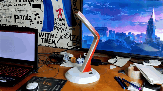

I added two diffusers to the lamp without any adhesive and the project is finally completed.

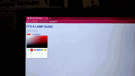

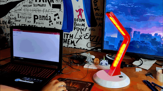

Now let's connect this setup with the internet and see the result of this built.

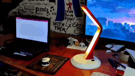

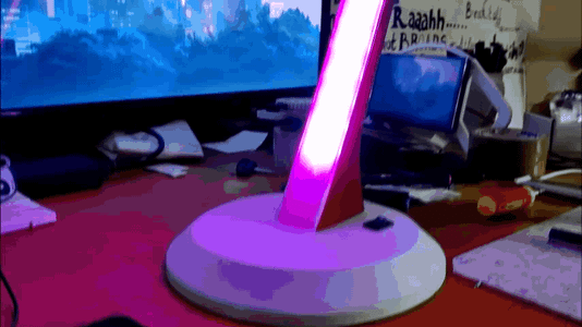

Step 20: RESULT!
we open any web browser and type in the IP address of the ESP8266 which we get from the serial monitor after programming the ESP module.
the web app allows us to control the brightness and color of the lamp, we can set any color with it and the whole toggling process took less than a second which was really cool. this is it for today guys,
