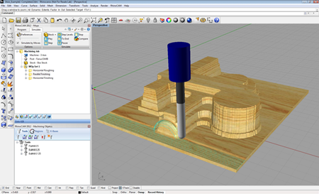

Step 3: 3. Developing Tooling
Next you'll need to import this file to a CAM software. Here I'm using RhinoCAM. If you attempting to cut Non-dense foam download the 'Feeds & Speeds' attachment included. This file has some recommended settings for cutting various materials which will work with most 4ft x 8ft mills.
Be sure to add tabs in your CAM software (this is an option in most tools) as this will keep the pieces in place while they are being cut.
