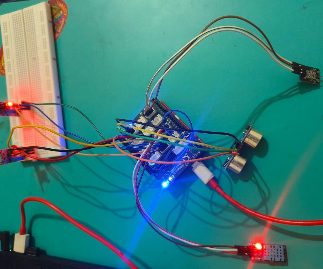

Pin Connections for ESP32 with DHT11:
  1. DHT11 Pinout:
  2. VCC: Power (3.3V or 5V)
  3. GND: Ground
  4. DATA: Data signal pin
  5. Connection to ESP32:
  6. DHT11 VCC3.3V or 5V on ESP32 (depends on your DHT11 module; many work on both voltages)
  7. DHT11 GNDGND on ESP32
  8. DHT11 DATAGPIO 5 on ESP32 (defined in your code as #define DHT_PIN 5)
  9. Optional (if your DHT11 module doesn’t have a built-in pull-up resistor):
  10. Connect a 10kΩ pull-up resistor between the DATA pin and the VCC pin of the DHT11.
Diagram:
lua
Copy code
DHT11 ESP32
VCC ------> 3.3V/5V
GND ------> GND
DATA ------> GPIO 5 (D5)
Ensure all connections are secure, and double-check that your ESP32 board and DHT11 sensor are powered appropriately. If the sensor has issues reading, try switching between 3.3V and 5V for the power source.
