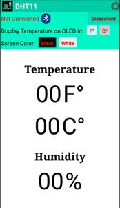

Step 6: Downloading the App
I have made the app in MIT APP INVENTOR. You don't have to make the app because I have provided the .apk file for the app. The app is called "DHT11.apk."
Step 7: Testing the Project
To test if the project is working properly, check the temperature the DHT11 is displaying on the OLED screen and check the thermometer in your house and see if they match. If they don't, there could be a possibility that the room the sensor is in is warmer or colder, which is why the temperatures are not matching. You can also test the sensor by putting a piece of ice on it and see if the temperate is dropping. You can also connect the HC-05 over Bluetooth to the app. The values on the app should be updating live. You can also change the temperature being displayed on the app from Fahrenheit to Celsius from the app. Click on the settings icon, then click on Fahrenheit or Celsius. Whichever one you choose will be displayed on the OLED.
