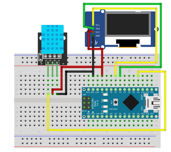

Step 2: DHT11 Wiring
Connect the DHT11 as following:
Arduino >> DHT11
GND >> GND
5V >> VCC
A0 >> Signal
Step 3: OLED Wiring
Connect the OLED as following:
Arduino >> OLED
GND >> GND
5V >> VCC
A4 >> SDA
A5 >> SCL

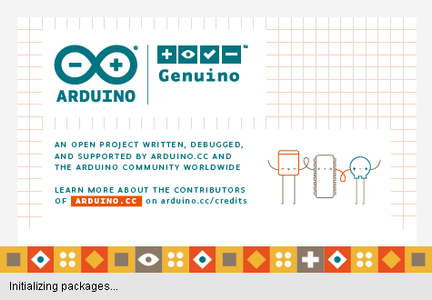

Step 4: Uploading the Program
Open the program on Arduino IDE. Once it is open, compile the sketch to see if it is clear of error and upload it. Make sure you have all the libraries download before you upload the program. After you have uploaded the program, you should see the screen turn on and display "Aced Inventor." After 2 seconds it will then display the temperature in Celsius, Fahrenheit, and Humidity. You will also have to download the .zip OLED_I2c library.
