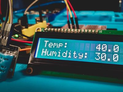

this is a simple project
You can understand the basics of the LCD with I2C and also how to find temperature and humidity of the room.

Step 1: Components Needed
The things i have used in this project is
Arduino uno
DHT11 sensor
LCD with I2C module
Jumperwires
Breadboard
Step 2: Circuit Diagram
Step 3: Arduino CODE
#include #include #include // for DHT11, // VCC: 5V or 3V // GND: GND // DATA: 3 int pinDHT11 = 3; SimpleDHT11 dht11(pinDHT11); LiquidCrystal_I2C lcd(0x27, 16, 2); void setup() { Serial.begin(115200); } void loop() { // start working... Serial.println("================================="); Serial.println("Sample DHT11..."); // read without samples. byte temperature = 0; byte humidity = 0; int err = SimpleDHTErrSuccess; if ((err = dht11.read(&temperature, &humidity, NULL)) != SimpleDHTErrSuccess) { Serial.print("Read DHT11 failed, err="); Serial.println(err);delay(1000); return; } lcd.begin(); // Turn on the blacklight and print a message. lcd.backlight(); lcd.print("tempature "); lcd.print((int)temperature); lcd.setCursor(0, 1); lcd.print("humidity "); lcd.print((int)humidity); delay(1000); }

YOU SHOULD DOWNLOAD SIMPLEDHT LIBRARY TO GET THE PROJECT WORK CORRECTLY
