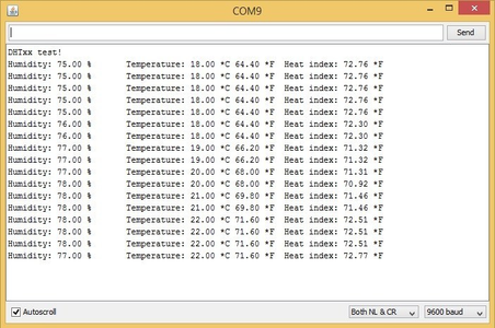

Step 4: For Example
After uploading the code to the Arduino, open the Serial Monitor at a baud rate of 9600. You should get a sensor reading every two seconds. This is what you should see in the Arduino IDE serial monitor.
