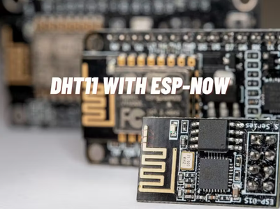

Introduction: DHT11 With ESPNOW
This tutorial will guide you to transfer the DHT11 sensor data from ESP32 with the help of the ESP-NOW protocol, all will receive the same DHT11 data in another ESP32 board using the same ESP-NOW protocol.
