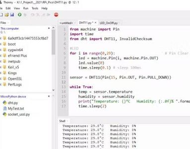

Step 4: Example Code
There is no need for the "pin clear" part, but depending on the board, there is a part where the pin is working, so I put it in.
I made it so that the temperature and humidity were well expressed, and I made it print out once every 2 seconds.
The output is as below...
I am using a tool called Thonny to easily compile and use MicroPython!!
