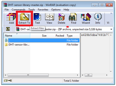

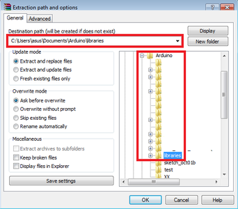

Step 4: DHT Library
Communicating with the Humidity / Temperature Sensor Module requires a driver for the DHT22 sensor. The simplest way to install the driver is to download the DHT library. Download the ZIP file below > Open Zip File > Extract to your Arduino Uno Library folder. Refer the image above for your references.

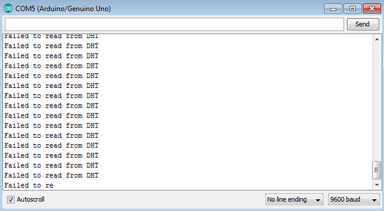

Step 7: Serial Monitor
After you has succesfully uploaded the sample source code into your Arduino Uno Board. Open your Serial Monitor and it will print as shown in the image above.
Step 8: Result
As the result :
1. when you key-in number '1', serial monitor will print the humidity value.
2. When you key-in number '2', serial monitor will print the temperature value.
3. When you key-in other than '1' and '2', serial monitor will print "Failed. Invalid option entered".
4. If they are NaN (not a number), serial monitor will print "Failed to read from DHT". OR it could be that you did not declare the correct pin for DHTPIN in the code.
NOTE : Make sure to declare the same data pin number you connect on your Arduino Uno Board in your Arduino IDE. If you connect it on Digital pin 3, declare DHTPIN 3.
