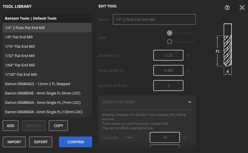

In the Bantam Tools software, under Plans, click Open Files and select the Humidity-Temperature-Sensor.brd file. You have the option to use both the 1/32” and 1/64” flat end mills or just the 1/64” flat end mill for this job. Using both end mills will cut your mill time to about three minutes, and if you only use the 1/64” end mill, it’ll take roughly eight minutes. For this project, we used the following recipes.
For the 1/64” flat end mill:
- Feed Rate: 50 in/min
- Plunge Rate: 15.00 in
- Spindle Speed: 25,000 RPM
- Stepover: 50%
- Pass Depth: 0.007 in
For the 1/32" flat end mill:
- Feed Rate: 59 in/min
- Plunge Rate: 15 in
- Stepover: 49%
- Pass Depth: 0.010 in
Your mill time will also vary depending on your speeds and feeds recipes. If you’d like to adjust your speeds and feeds to match ours, click File > Tool Library > Add Tool. Name your new tools and then input the speeds and feeds recipes. You can learn more about customizing your Tool Library in our guide.

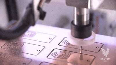

Ready? Click Start Milling.
If you’re using both the 1/64” and 1/32” flat end mills, the software will prompt you to change your tool. Swap out your tool, install the new one with the bit fan, locate the tool, and select Mill All Visible to finish your job.

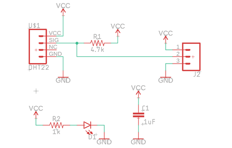

On the sensor module, the DHT22 is intended to rest perpendicular to the board. There’s a 4.7K pull-up resistor on the data line, a 0.1uF filtering capacitor on the VCC line, and a power-indicating LED via a 1K resistor. The 90º male headers will allow for easy breadboarding.

Now that you’ve assembled the circuit board, it’s time to program and test your sensor. Install the Adafruit DHT-sensor-library, if you haven’t already done so. Then select Examples > DHT Sensor Library > DHTtester. Connect the 5V to pin 1 on the module, D2 to pin 2, and GND to pin 3. The DHT22 is the default typeset in the example sketch, so you’ll need to change this in the code if you’re using a different DHTxx sensor. When you’re finished, upload the code and open the Serial Monitor.
