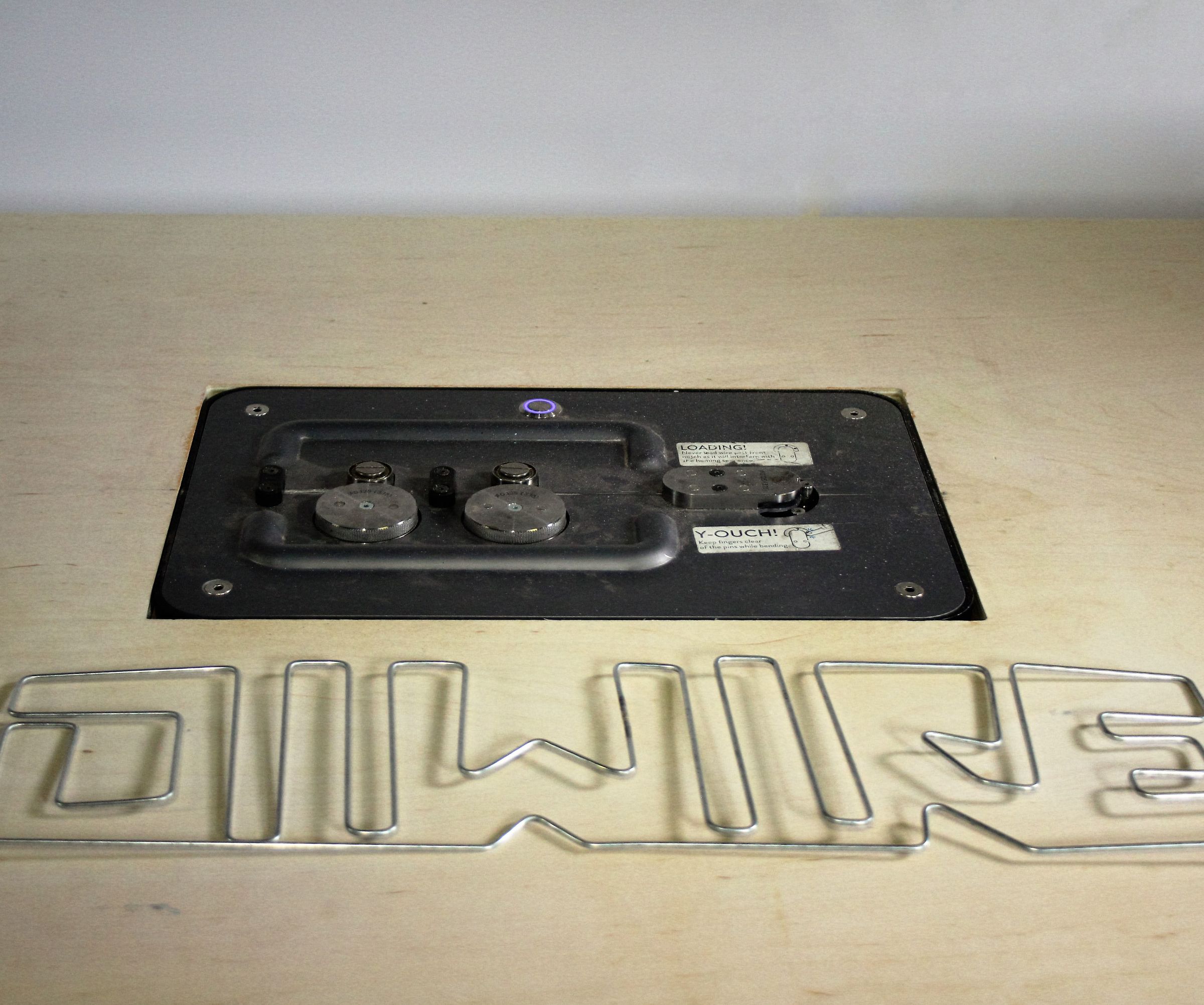

The DIWire lamp is a product that came from multiple prototypes using the DIWire Bender. It started as an upside down bowl on top of a poorly made lamp base. After multiple iterations it turned into a fully functional lamp that changes colors and utilizes multiple machines in its making. Im a senior at Riverpoint Academy. We have access to high quality equipment like CNC machines, 3D Printers, and Laser Cutters. This lamp was one of my projects that went trough many iterations. This is my result. Enjoy

Step 2: Bending the Wire
A. Inside the zipped file, open the folder that is labeled “Wire Bent Parts”. Inside of this folder you will find three parts that need to be bent. Bend 4 “Lamp Center Posts”, 4 “Lamp Outer Posts”, and 12 “Lampshade Spokes”.
B. Set these pieces aside as they will be used later in the assembly.
