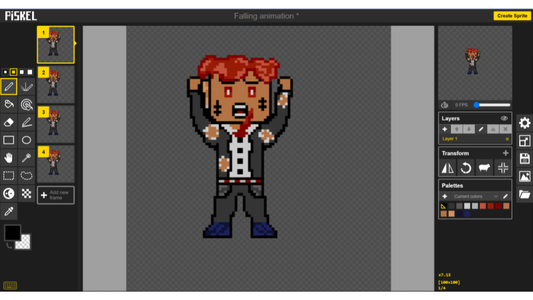

Step 3: Creating the Falling Animation
The next step was to create an animation for the character to play as he was falling through the game. My method for this was to keep the head and main body in the same place but shift the limbs, hair and tie to the left and right to make it look like he was actually falling.
(Make sure to use FRAMES not LAYERS)
To make the animation, turn on toggle onion skin right above it says Layers, which will allow you to see your last frame at a low opacity. This lets you change a little bit of each FRAME (left side) so that the sprite will be animated. Export the frames by going to settings, png spritesheet file export.
The first frame is the original falling frame then the 2nd is shifted one pixel to the left, the 3rd is also the original frame, and the 4th has it shifted a pixel to the right. When put together you get a fun animation of the character falling. You can see the animation by changing the FPS in the top right corner and opening a pop up to see the animation in a larger view. This was also made on a 100 x 100 canvas.

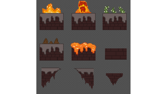

Step 6: Creating the Platforms
The next step was drawing the platforms. I first made the general block and chose the color scheme, you can choose any theme you want, be creative! Then I brainstormed ideas for different traps that could kill you if you were to fall on them in order to make the game more interesting.
The ideas I came up with were spikes, lava, thorny vines, fire and a lava monster. I made different variations of each trap and made it so that they could be attached to the left, right or just be left as standalone blocks. I also added the “traps” to the corner blocks to create an even larger variation. Unfortunately we were unable to use many of the blocks because they weren’t evenly spaced and couldn’t be properly selected in Unreal Engine.
Because we found out about this contest a bit too late I didn’t have the time to try to fix the issue so we just ran with what we were able to use. I did however research the issue and when you create this was supposed to use the grid available on piskel to make sure the various blocks it within the grid. Regardless, I created these platforms on 32 different frames on a 150 x 150 canvas. However, when you do it, you can create all the blocks on one frame, with each block occupying one grid square on a larger canvas.

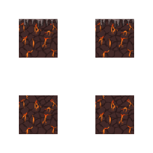

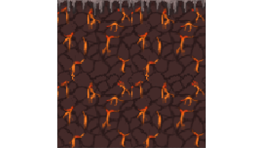

Step 7: Creating the Actual Background

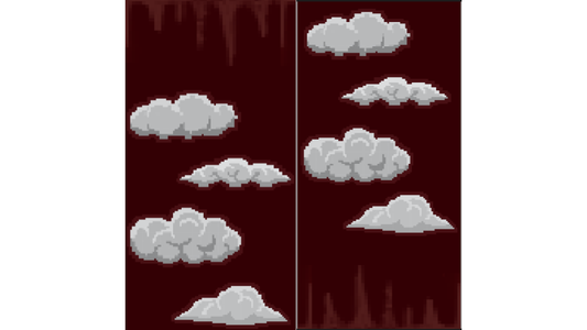

To create the background I started by looking up references and gathering ideas based on some work others have made. I settled on stalactites and clouds. The background and the clouds are mostly just one color, that was done using the bucket tool.
For the stalactites, I first drew them up top and copied them into a different piskel file to rotate them. After rotating it, I simply copied and pasted them to the bottom of the canvas.
This canvas was 100 pixels in width and 400 in height because the game should be way longer than it is wide, as the gameplay is about falling, not walking.

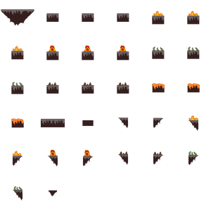

Step 10: Tile Set
Go to your png of the blocks you will use to build the level. This should be on one sheet with all the different blocks on it. Right click, hover over sprite actions and click create Tile set, adjust tile size on the right depending on how large your blocks are (we used 75 x 75).
You can cut off the empty border by adjusting border margins but as long as you used the grid method, this step is unnecessary. Then click on one of the blocks and apply a box to it. Repeat with all the blocks. To see the ones you applied a box to already, press colliding tiles on the top left. You can adjust individual collisions in the enlarged window if needed.

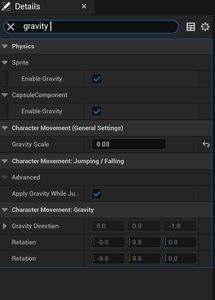

To slow down the character's falling speed, click on the blueprint self tab and search for gravity, then lower the gravity scale. Then search for max walk speed and lower that too.
