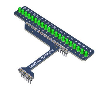

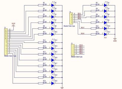

Step 2: SCHEMATIC DIAGRAM
The schematic diagram is very simple and flexible. For example in the case of the resistors you can use values from 220 Ohms until 10k Ohms, if you are planning to make a video with the board, I recommend you to use 10k Ohms value so the led will not shine a lot. In the oposive situation if you want the diode led shines a lot, so use the low value 220 Ohms.
In the case of the diode led 3mm, you can choose different colors (red, blue, yellow, orange or other), the point is that the dimension has to be 3mm, there is no space for diode led 5mm. the pcb is very compact.Also We have the pin headers, the original desing is with male pin header so the pcb will a shield for Arduino or Breadboard, but the option to use cables or female pin header is also welcome and will work efficiently.
► You can get the schematic in PDF: Here

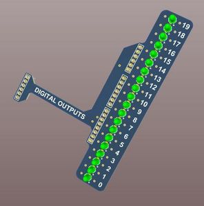

Step 3: PCB LAYOUT
In the case of the diode led 3mm, you can choose different colors (red, blue, yellow, orange or other), the point is that the dimension has to be 3mm, there is no space for diode led 5mm. the pcb is very compact. Also We have the pin headers, the original desing is with male pin header so the pcb will a shield for Arduino or Breadboard, but the option to use cables or female pin header is also welcome and will work efficiently.
You can also download the Gerber Files: Here
Step 4: 3D MODEL
One of the features of Altium Designer is the 3D visualization, the 3d visualization is important and it give us the posibility to see and check our PCB and how it would be in real, also it can show us the components distribution and dimensions. Before I did not consider this feature so important at all, but the 3d visualization can show us if our footprint dimensions are ok, if all the components will be places without touching each other by mistake, it does not matter if your components are SMT or PTH (small or big), it is always better to see that every component will fit correctly.
► Also very important to remember, if you are going to add 3d models, be carefull that you add in the Step AP214 format, the others extensions and formats can not work correctly.
Step 5: PDF 3D
According to the software that you are using, You can also get the 3d Models, as I commented you before, this board was desinged On the Altium Designer Software which has this nice option to get the 3d pdf, so later you can share with your coworkers or clients to show the advances of the pcb, without the software installed. After generating the pdf3d, just you need to open with Adobe reader and you will see your 3d board, and also rotate, show or hide layers.

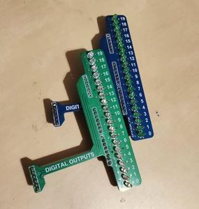

Step 6: PCB MANUFACTURE
Once we finished our shield board; it is time to bring it to life. In order to manufacture our board, We are going to use JLCPB Services.In case that you do not have an account yet, check out the bellow link

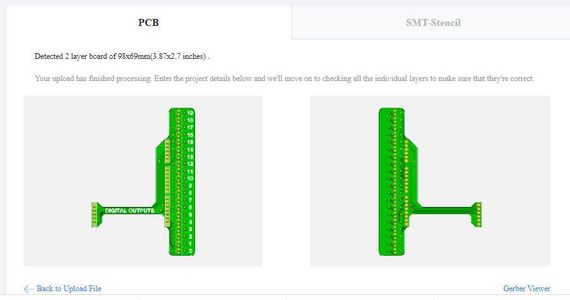

Once We are register, and We logged in our account, We are ready to submit an order and receive our board in a very short time. In this case We need to update first the gerber files, which contains all the necesary information to build the pcb, You can get the gerber files in the link bellow.
Upload your gerber files
This is the first step, after we have ready our schematic and pcb layout, and after we generated the gerber files, We should upload this files to the JLCPCB website service.

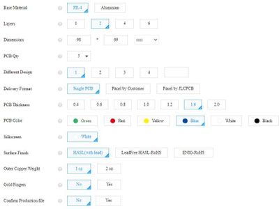

Indicate the features
After the upload of our gerber files, We need to indicate the features of the board, in the next picture you can see the options available.

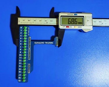

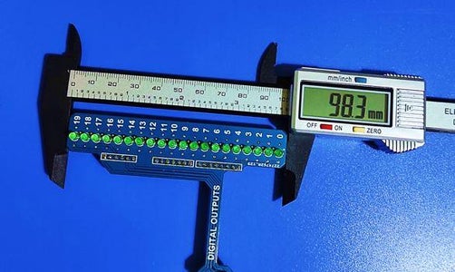

Step 8: TESTING THE BOARD
Now our Digital Output shield board is ready, and we can test it as well. So in order to do that first we need to mount in our Arduino board or breadboard. Let's make the test with an Arduino Uno board, because it is the most used board and I am almost sure that you must have this board too. Now just we need to upload a sketch. Attached you will find and example, and other examples.
