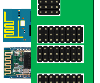

The controller itself is a simply build; a Wemos D1 (ESP8266 board in the Arduino Uno form factor), a 4 channel arduino relay shield, and a fantastic case (the ArduiBox from hwhardsoft.de) with it's additional OLED display shield.
While simple, it is a very versatile unit; the onboard relays can control a variety of devices in a home automation setup or trigger all kinds of equipment, the Wemos pins broken out to the screw terminals can be used to interface with a vast array of inputs and outputs, the case's built in prototyping area can be used to add to your c ircuitry (such as perhaps adding a port expander to add more Analog pins to the Wemos' solitary Analog pin), and the opnboard display can show a variety of sensor information, relay status or even the IP address information for the device.

Step 3: Assembly: Wemos D1
The Wemos D1 is an ESP8266 powered board in the Arduino Uno format.
The ESP8266 is a fantastic chip, bringing Wi-Fi functionality to the project for a low cost.
Since the chip became popular support has grown, including an easy to use Arduino library.
Arduino IDE compatibility and the Uno form factor make the Wemos D1 perfect to use in this project.
ok
Plug it into the Arduino header pins in the ArduiBox enclosure.
