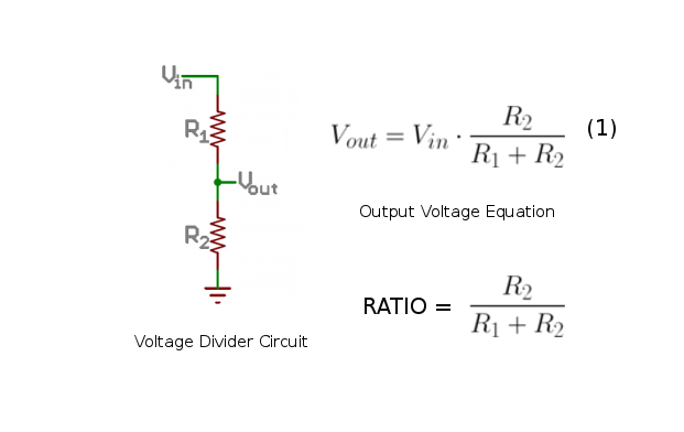

This section discusses the underlying concepts for the multi-switch method and develops the equations required for stand-alone calculation of unique identifiers for each of the 16 possible dip switch setting configurations. These identifiers can then be used in an application program to associate a switch configuration with an action. For example, you might want the setting - switch 1 on, switch 2 off, switch 3 off, switch 4 off (1,0,0,0) - to play Amazing Grace and (0,1,0,0) to play Lion Sleeps Tonight. For brevity and conciseness the configuration identifiers are referred to as comparators in the remainder of the document.
The foundational concept for the multi-switch method is the Voltage Divider circuit which consists of 2 in series resistors connected to an input voltage. The output voltage lead is connected between the resistors, R1 and R2, as shown above. The divider output voltage is calculated as the input voltage multiplied by the ratio of resistor R2 to the sum of R1 and R2 (equation 1). This ratio is always less than 1 so the output voltage is always smaller than the input voltage.
As indicated in the design diagram above the multi-switch is configured as a voltage divider with R2 fixed and R1 equal to the composite/equivalent resistance for the 4 dip switch resistors. The value of R1 depends on which dip switches are turned on and, therefore, contributing to the composite resistance. Since the dip switch resistors are in parallel, the equivalent resistance calculation equation is stated in terms of the reciprocals of the component resistors. For our configuration and the case that all switches are turned on, the equation becomes
1/R1 = 1/80000 + 1/40000 + 1/20000 + 1/10000
giving R1 = 5333.33 volts. To account for the fact that most settings have at least one of the switches turned off, the switch state is used as a multiplier:
1/R1 = s1*1/80000 + s2*1/40000 + s3*1/20000 + s4*1/10000 (2)
where the state multiplier, si, is equal to 1 if the switch is turned on and equal to 0 if the switch is turned off. R1 can now be used to calculate the resistance ratio needed in equation 1. Using the case where all switches are on as the example again
RATIO = R2/(R1+R2) = 10000/(5333.33+10000) = .6522
The last step in calculation of the predicted comparator value is multiplication of the RATIO by 1023 in order to emulate the effect of the analogRead function. The identifier for the case where all switches are on is then
comparator15 = 1023*.6522 = 667
