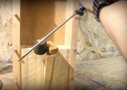

Step 6: Installing the Blocking
To conceal the giant spike, I cut up some pallet wood chunks and fit them into the bottom of the box.
The pieces are all glued and brad nailed together except for the center piece which is screwed into the piece next to it to act as a pivot point to get Jimmy in and out. The blocks to the left and right are glued in place with some wood glue.
The box and log are held in place with hot glue so that they don't move when pulling out the ice pick.
