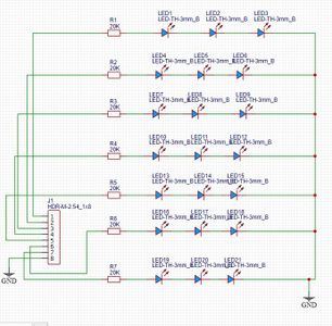

Step 1: SCHEMATIC DIAGRAM
Here we will see the schematic diagram made in the easyeda software with all the electronic components and their respective values.

IN THIS PROJECT WE MADE IT WORK FROM 8V TO 12V SINCE THERE ARE 3 LEDS IN SERIES AND LIMITING THE CURRENT BY A 220ohm RESISTANCE

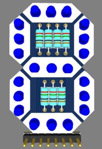

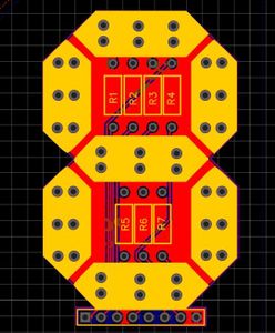

Step 5: EASYEDA
This project was made in the Easyeda software as we can see the tracks and the 3D image of the project working perfectly are no difficulty
