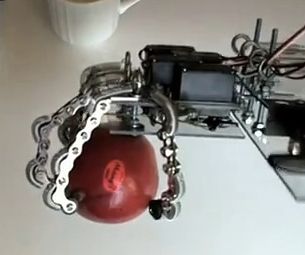

I designed and built this robotic hand and the controller for less than $200. The fingers and thumb are controlled by servo motors. The first video shows the hand in action. The second video shows how to make the hand.

1 bicycle chain

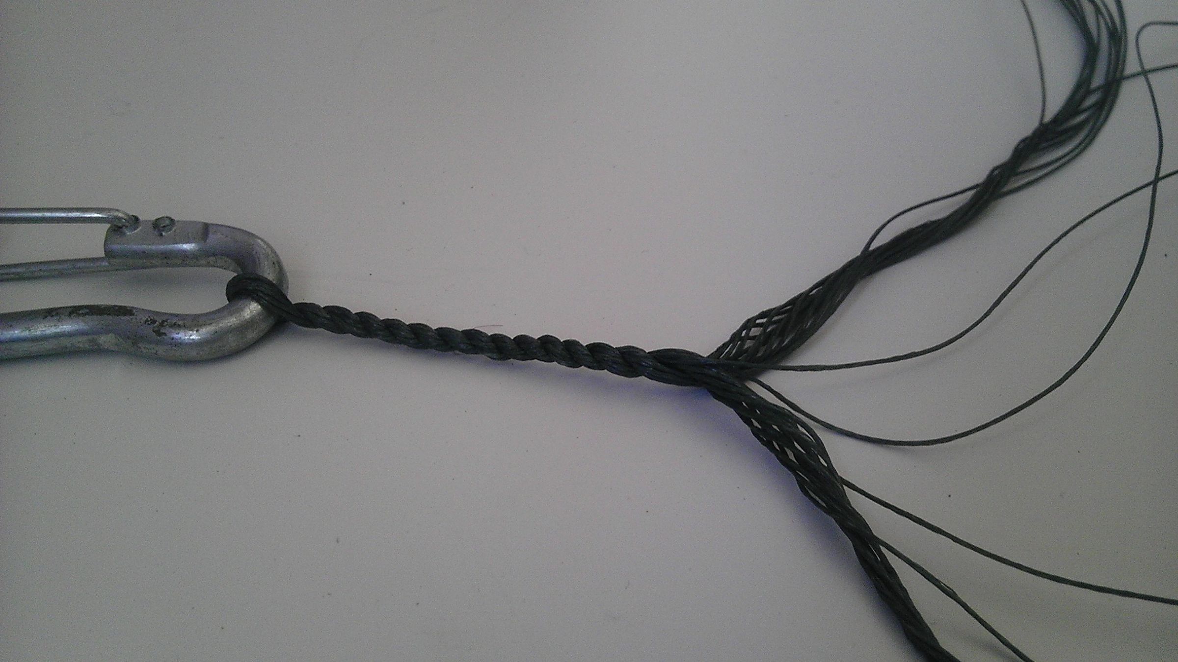

1 spool SpiderWire fishing line (It's made with Dyneema, and I used 3 strands of 65 pound test line, which I made into a rope for each finger)
see my video for making rope with this fishing line: https://www.instructables.com/id/How-to-Make-the-Worlds-Strongest-Rope/

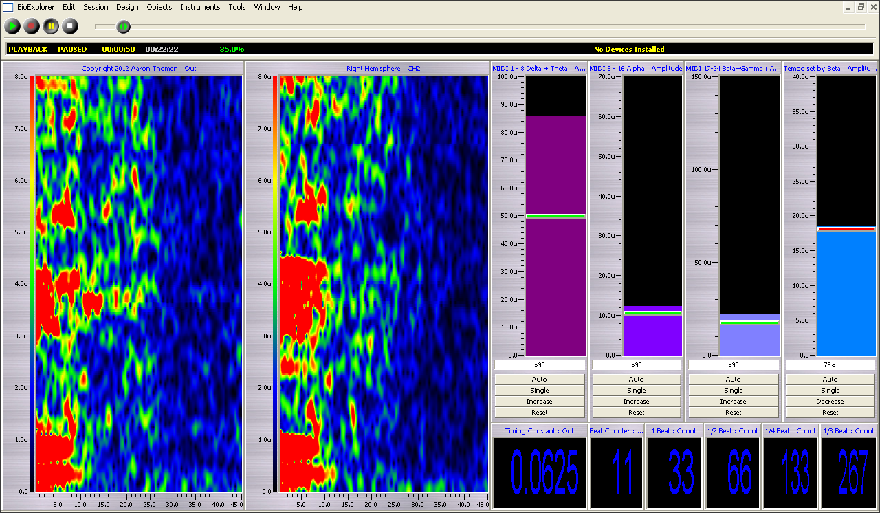

I have connected this robotic hand to my EEG machine. I used the electrodes to detect the muscle impulses in my forearm. I didn't spend a lot of time on it, and individual finger control was tricky (signal interference from other muscles), but it did work. Another option would be to trigger the whole hand to close using the movement of another body part (using flex sensors). Fine motor control will be very difficult, unless your friend is willing to let you surgically implant electrodes, and if he's a good enough friend he won't have a problem with this.
