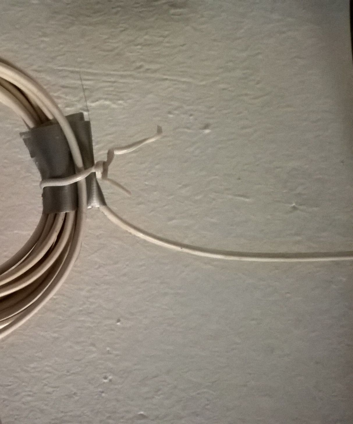

Next step is the wireless antenna, the orange and yellow drawing. This section we need to use the common cable TV cable. So first cut off the plastic jacket about 15-20 cm length, depend on the center core round / turns , if you planning for testing the center core round / turns, maybe good idea about 20cm. depend on the center core round / turns diameter. Now you can see the [metallic shield] like a spider web, cut off this metallic shield and look at the drawing again, the red line is the metallic shield to be installed. No waste. Just twisted down the metallic shield become a wire without cutting [cut it if too long ]and fit into the connector block at the red line and tighten, not necessary a U shape. Then back to the cable, cut off the dielectric insulator carefully, we need the center core for building the wireless antenna.
Back to the drawing again. About 5cm from the edge of the center core [ or start at plastic jacket edge depend on the length of center core ], we need to make 5 round / turns clockwise, E GSM 900 2G, we can do it using screw driver [ 3-6 mm phillips screw drive ], just bend the center core round and round / turns on the rod. Then straight the center core both area like the photo. Now we need to mount this wireless antenna to the 3G antenna. Look at the drawing how this done. Remember the edge of the center core wire have to joined the iron wire and tighten. Do not forget the red wire.
After some testing, B1-WCDMA 2100, 4G have to be center core 7 round /turns at outdoor unit, and center core 5 round / turns at indoor unit. Use your smartphone searching for the location have STRONG 4G signal to put the outdoor unit.
A good signal strength define is maybe a stable 3 bar 2G signal, not a unstable signal strength jump up and down too often. Probably take a while for getting the right place.
If you not very sure, just make it 7 round /turns at out door unit and 5 round /turns at indoor unit. If the signal strength still too weak, you can trial and error increase the outdoor unit the center core round / turns 1 at a time. 1 round / turns mean 1 complete circle.
So you need both edge [ cutting edge ] of the cable to be the wireless antenna. Better install the cable one end at the roof top or near roof top, open area. One end is inside the house, anywhere you like.
Completed assembly, both end of the TV cable have a finished LauC2 antenna like the photo.
