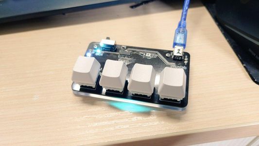

That is why I designed the "4xMacropad" - The business card size 4 key mechanical macropad. (Technically speaking the dimension is all "business card size" except the height)

Step 1: Print the PCB and Mount
The most important part of this project is the PCB. The macro-keypad is designed with a open PCB design, which means the PCB is directly exposed on top of the device, making it a bit scifi style to look at.

Step 2: Solder the Components
For starters, I recommend starting from the smallest to the largest components. You can solder starting from the CH552G, then the surrounding 0805 ICs then the other remaining DIP type parts. Follow the silk screen instruction and solder everything in its correct locations.
There are also 3 optional RGB channel which they can be controlled by advance coding in the MCU. If you want to make some light pollution with those LEDs, you can also solder some extra 10k resistors and 0805 LEDs according to the silkscreen printing.

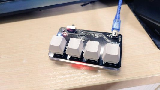

Step 3: Power Test
Before you plug it into your computer, you should do a power test using a lab bench power supply to the labeled 5V and GND test pad on the PCB. This is important to make sure there are nothing is shorted during the soldering process and the PCB is safe to plug into your computer.
Once powered on in, without any code in the MCU, you should be able to see the LED lights up in 50% brightness. That is because the LED control pins are "floating", which is normal.
If everything is working, you can now unplug the macropad from your lab bench power supply and start programming!

Step 8: Your $3 Macropad Is Now Completed!
Now, you got yourself a little cute, low cost and good looking macropad where you can carry it to events and show off to people who also love mechanical keyboards!
