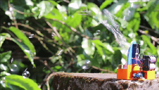

Hello friends, Christmas is around the corner and ahead of that new year, In short, this holiday season is full of fun, and most end with parties! How about making a 3D printed bubble blower machine at home?
Yeah, That is a fantastic idea I would say because building this is one part, and using this is another level of fun.
In this instructable, I will show you how I made this 3d printed bubble blowing machine.
The special feature here is you have the option to control the generation rate of bubbles, This has rechargeable high capacity batteries that will keep the fun going, whether it is a garden party or an indoor party this fits in everything.
I also attached STL files that I made with Tinkercad, a Detailed explanation of the circuit and step by step build instructions, So what are you waiting for? Gather the materials to get started.

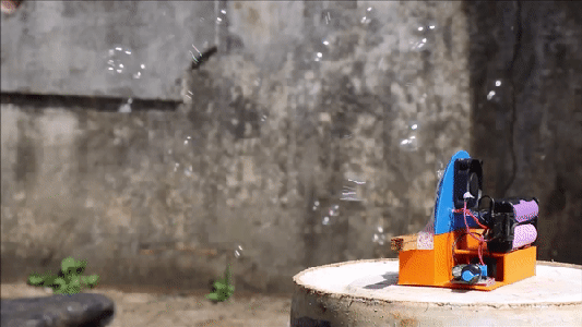

Step 4: Circuit and Assembling Electronics
The circuit has two parts
First is the servo circuit
Servo has 2 wires and this wire is directly connected to the speed controller board.
The battery(single aaa battery) is then connected to the holder and its terminals are connected to this speed control board power input slot
Second is the DC fan circuit
Here I will be using 2 batteries connected to the battery holder and a switch.
This is then connected to the DC fan directly, This part doesn't need any speed control as we need the fan to work at its maximum capacity to blow the air.

Step 5: Working
To use this machine, follow these simple steps.
I used dishwash liquid as a bubble making liquid, Alternatively, you can use shampoo for every 100ml of water mix 5 to 10ml of shampoo, mix it well on a bottle, and pour it into the collecting tray on the machine.
Turn on the bubble wheel servo and keep the speed to a minimum and wait for a few seconds.
Now turn on the DC fan that blows air to the bubble wheel, Here you have to take care of the wind, if the air blows in the opposite direction of the DC fan air flow changes the direction of the machine.
The rate of bubbles can be increased or decreased by changing the speed of the wheel, Just turn the knob of the speed controller and you are good to go.
That was all about making this machine, Build it for yourself, and see the results, Any questions we have comment box to connect us!
