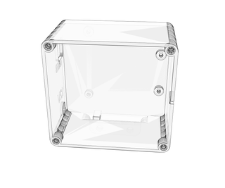

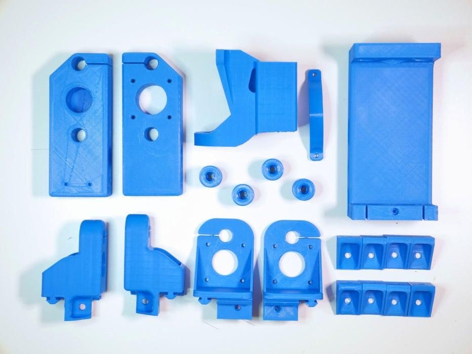

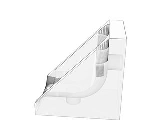

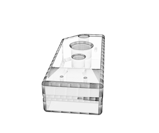

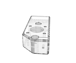

Step 3: 3D Printing
3D printed parts are very important in this project so I would like to talk more about how to print and post-process them.
A lot of people may say that it's extremely important to keep infill super high but from what I noticed using very high infill doesn't help a lot, of course, there's nothing wrong with using high infill but in my opinion infill of about 20-40% is fine.
I printed all of my parts with PLA but it's better to print them with PETG cost of PETG is almost the same and both of them are easy to print but PETG is a little bit more flexible so it's harder to break it.
For some of the files, you need to use supports, make sure to put them in the proper orientation so that there is not a lot of support material to remove and that you are able to remove it.
You don't have to print parts labeled as OLD, those are old versions of some files that I shared in case someone wants to use them.
You can also find .f3d, .iges and .step files so you can easily edit my project.
Be careful while post-processing those parts, it's easy to break them. Also, make sure that you are able to fit all of the bearings inside, you should use a vise to put them in place so it should be tight. You may also need to sand slightly those pins that go into aluminum profiles it depends on the accuracy of your 3D printer.
There are also two "tools" those are not part of the CNC but are very useful to drill holes in aluminium profiles and wooden bed.

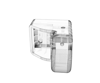

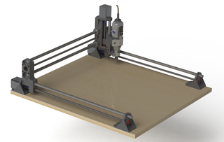

Step 5: Z Axis
To make things easier we will start with the assembly of the Z axis. Put two rods in Z-axis carriage but not all the way through we have to put there Dremel holder too. Dremel holder should move freely on the linear bearings. 608zz beating should be already in place in the hole on the bottom of Z-axis carriage. Now we can install a stepper motor with a lead screw and 3D printed coupler. Fix the motor with M3 screws and make sure that both rods are secured with a screw at the bottom. To make it easier for further use point the stepper motor connector backward because that's where we will install electronics.
Step 6: X Axis

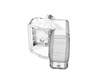

Tighten brass nuts to both 3D printed parts. Grab one of the X-axis carriages and join two rods to it. Then put a Z-axis carriage on those rods and close with the other X-axis carriage on the opposite side. Attach a motor with a lead screw to 3D printed part with M3 screws.
Step 7: Y Axis and Aluminium Frame

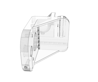

Y-axis is directly connected to the main frame of this machine. It's made out of 20x20mm aluminum extrusion profiles connected together with screws to ensure rigidity. I choose 20x20mm profiles because those are easy to get, not that expensive and fit the size of this machine. Bigger profiles could be used but for such a small machine it wouldn't make a lot of difference. Because this machine is modular you don't have to use specific lengths of the profiles. Do you want to make a big machine? -> use longer profiles. Do you want to make a smaller machine? -> use shorter profiles. I cut my profiles to 60cm (we need two of them) and 30cm (we need 4). Once you have profiles cut to a length that you want we can start drilling holes. We need to drill holes on the ends of longer profiles, to make that easier I designed 3D printable tool that you can put on the profile and then drill a hole with 6.5mm drill bit. It's 3D printable so made out of plastic, it's easy to drill it out but we only need to make 4 holes with this tool so that shouldn't be a big problem. On both ends of 2 shorter profiles, we have to make a thread with a tap. It's a good idea to pre-drill a hole for the tap with 5.2mm drill bit and then create an M6 thread.

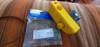

Let's start by attaching stepper motors to 3D printed parts with M3 screws. We can also fix couplers to the motors. Put in place M5 screws with hammer nut to make it easier to assemble. You can slide 3D printed part with a motor on to the longer aluminum profile. On the other side, you can fix a shorter profile as shown on the pictures. Tighten the screws with hammer nuts. Also, don't forget to tighten an M6 screw on the side of the longer aluminum profile. Do the same on the other side. Attach middle brackets (you can install as many as you want (2 or 3) with corner connectors, M5 screws and hammer nuts.
We already installed Y-axis motor supports and lead screw support, right now we have to attach lead screws and Y-axis rods. Again thanks to the modularity of this machine it's up to you how long rods and lead screws will be (You have to figure out good length so that it will work with the length of your aluminum profiles).
It's time to connect X axis with the Y-axis, grab the X-axis (with Z-axis already installed) and put it on the rods and lead screws, you will have to rotate lead screws with your fingers to push the X-axis back a little bit

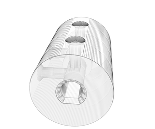

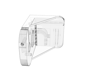

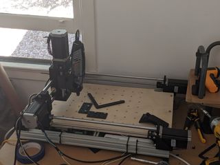

Step 9: Spindle
As the name of this project insists as a spindle I use a Dremel tool model 3000, there are already some people that successfully use a different model like 4000 or even completely different spindles. At the end of this instructable, I also write a little bit about the different spindle that I want to use with this machine. That's because Dremel limit's you only to 1/8 inch bits and also because of high rpm and low torque it's not ideal for machining for example aluminum (but it's possible). As long as you only want to machine wood, MDF, acrylic and even for delicate aluminum job Dremel works fine but there is no way to use bigger bit's for faster machining, there are not as many bits with a 1/8 inch shank as others and Dremel is relatively hard to mount.
But still, this is a super cheap entry-level solution for your first CNC with speed control and it's really good quality. You can always upgrade it later.
At the beginning of this project I wanted to add a relay to turn on and off the Dremel with a G-code command but because of some problems (I would have to add a socket to plug in a Dremel and then connect that to a wall outlet and protect all of that so that it would be safe, it's not worth it and it's hard to fit all of that on such small machine) I decided not to use it.
I was thinking a lot about the way of how Dremel should be attached to the spindle holder. Here is how I did it. There is a nut on the bottom of the Dremel, I thought that I can use it to fix it to the 3D printed part. That didn't work as good as I wanted to. So I added a support structure in the middle of the Dremel with a clamp so that you can squeeze it with M3 screws and nuts.
So every time I am machining something I have to remember to turn on the Dremel, I can also easily control the RPM of the Dremel with the slider on the top of it.

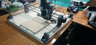

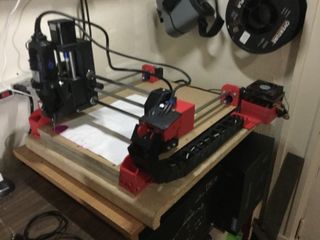

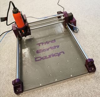

Step 17: Result
The result of this project just blows my mind! When I started it I just wanted to see if it is possible to create a 3D printed CNC machine, I wanted to build a tool that I will be able to use in my further projects. Right from the beginning of it, I knew that I will publish online all of the files and the instruction but I had never thought that this project will be so popular and that so many people will build it (check out next step). That's the biggest project of mine so far! Because of some problems and a lot of upgrades and tweaks that I did to the machine, it took me a long time before finishing this instructable, but I wanted it to be perfect and as detailed as possible so that everyone will be able to easily build an inexpensive CNC machine. Above you can see the newest images of the Dremel CNC with nice cable management and some small upgrades. There are also images of stuff that I milled on my machine. If you want to see what others made on Dremel CNC joint the Facebook group!

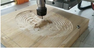

Step 18: How to Mill?
Choosing proper feeds and depth of cut is really just about experimenting. Start slow and shallow, slowly increase the speed and see what happen. Be careful, it's easy to break a milling bit. Keep in mind that going slow is as bad as going too fast, you need to be in between for best results. Here are the settings that I use:
Wood, MDF:
  • Feed: 800mm/min
  • Depth of cut: 3mm
  • Usually, I use adaptive clearing for everything and 2d contour for contour cut
  • Dremel switch 8/10
Acrylic:
  • Feed: 500mm/min
  • Depth of cut: 1mm
  • Dremel switch 6/10
Aluminum:
  • Feedrate: 800mm/min
  • Depth of cut: 0.2mm
  • Dremel at full speed
Keep in mind that depends on your setup those values may not work at all!!!
