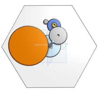

Step 2: CAD It - Geometry & Base Plate
I started off by creating the geometry sketch for the base plate, which allows me to check whether all of the gears would fit without interfering with each other. Moreover, I can also use this to minimize space.
Secondly, I made the bottom plate. The bottom plate includes holes for the standoffs between plates and holes for bearings to go in.

Afterwards, I added the servo. This was attached to the first gear I made, which was a small ratio gear to turn 1 rotation per second to 1 rotation per 60 seconds for the second hand. Since the servo used is tiny, and the holes in the servo attachment are too small for screws to pass through (made for strings and wires), I opted to use friction again, holding the attachment in place like a mold.
I had to make sure that there was the perfect hole shape so that the servo would not interfere with the middle plate, but could also attach to it using its two screws.
In addition, I lightened the gears using the Lighten featurescript to save weight and to give a cool look to the gears.
Finally, I put the entire part studio into the assembly, fixed the origin cube and grouped all static parts to it, and added revolute and gear ratio mates to test the viability of my clock. Luckily, there were no issues.

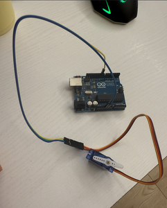

The first part is soldering the two connectors together. This is pretty straightforward for any engineering student; you first sleeve the heat shrink tube, solder, and then cover it with the heat shrink tube.
The second part is attaching the servo to the Arduino UNO. The servo that you use must be a continuously rotating servo (no rotational limits). Attach the brown wire to ground (GND), the red wire to the 5 volts power output (5V), and the yellow wire to D9, where the information is transferred.
Remember to screw on the servo in the correct place, and use double-sided tape for the Arduino and the battery. Moreover, I used clear tape to attach the wires cleanly and seamlessly, creating the effect that the wires are held together by nothing.

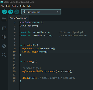

Step 11: Coding & Calibration
The code for this is simple.
Basically, the code writes 3 things:
- The servo's information route is wired on pin D8
- The Arduino sends a signal in µs to the servo
After careful calibration, I found that the signal that translates to 1 revolution per second is 1194 µs.
The code in action is embedded above.
