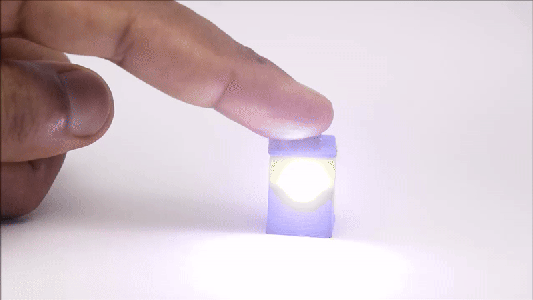

Hello fellow DIY enthusiasts in this project i will show you how i made this 3d printed flashlight that has wireless charging support feature
The aim was to make a small but powerful flashlight that can be carried without any hassle when you are wandering around
This is soo small that even if you keep a coin infront of it the flashlight will still look small! The overall body of flashlight is under 2cm can you believe that?
To charge this i have made a small wireless charging station and if you just keep this flashlight over the panel the light will start charging automatically
It gives a decent backup compared to its size, the light is sealed from all the directions and i haven't tested it for being water proof, i will test it and will update how it went
The best part here is all the parts for the frame of this light is 3d printed so that you don't need to worry about marking or missing the measurements this will save a lot of time
You can also add it as a keychain by adding a small hole and making it as a keyring! i personally didn't1W want to do so since if i did that this flashlight is soo cute to see that many may steal it! Lol sorry if this was a bad joke!
How cool are these features? i tried my level best to make it waterproof since we are using wireless charging here to recharge the light

Using this is not as complex as making the circuit for this flashlight! I recommend to carry this tiny little flashlight wherever you go because we never know when your car breaks down or when you might need an additonal flashlamp whenever you are on your trekking.
To turn on this light all you have to do is press on the toggle switch and the lamp turns on only untill you keep on pressing the button
After you release the button the light stops glowing, Now you may wonder why didnt you add a simple on and off switch?
The answer is simple, if i added that the wastage of energy would be more, Using this toggle switch will add more backup time to this light
