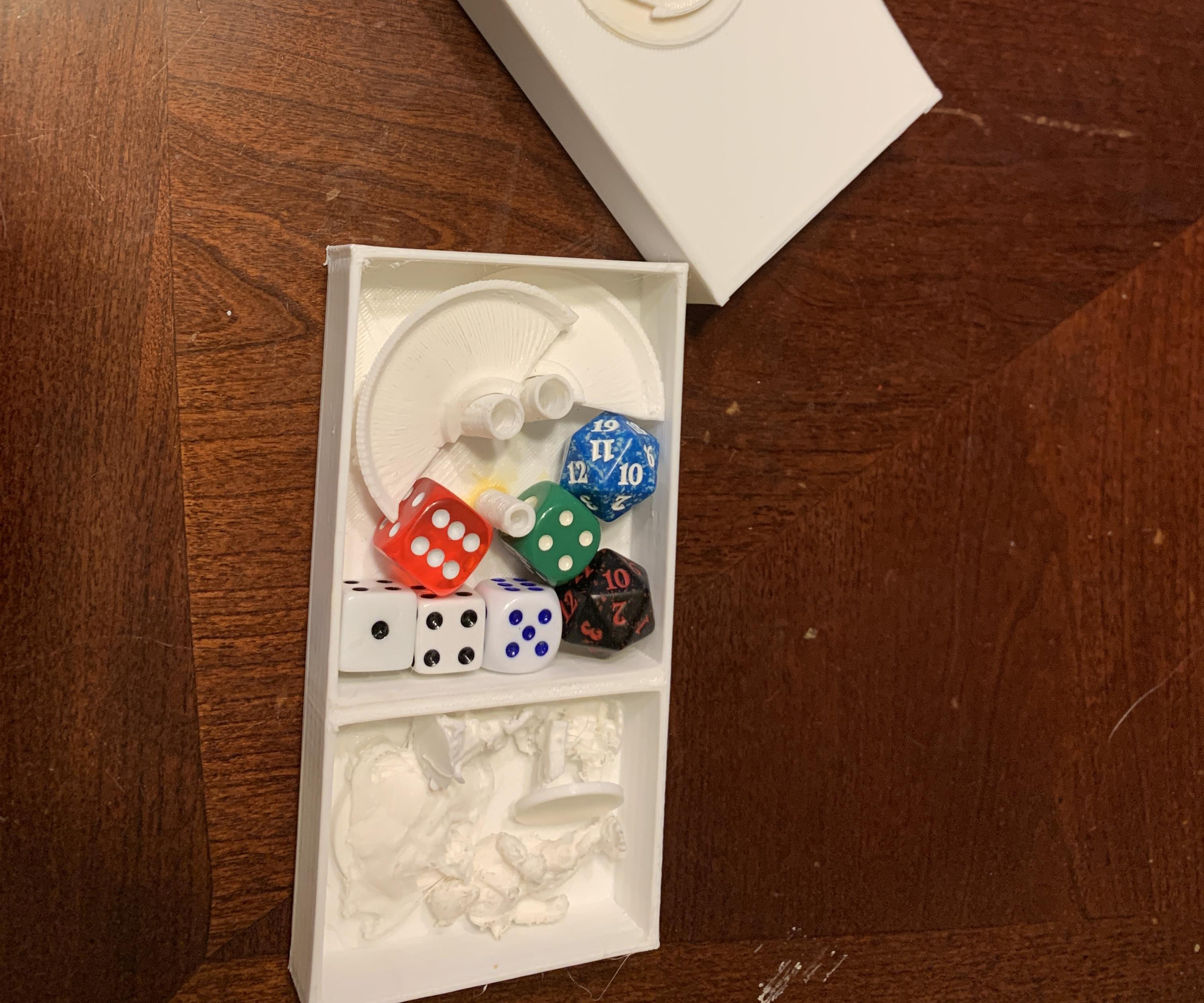

If you would like to make any of my phone cases here are the files:
I have made a special Space Case if anybody would like to make it on their own time.
The one with the spider is a symbol from a card game called Magic the Gathering.
In total, I have had to make 7- 8 different versions of the phone case to get everything that I wanted.
